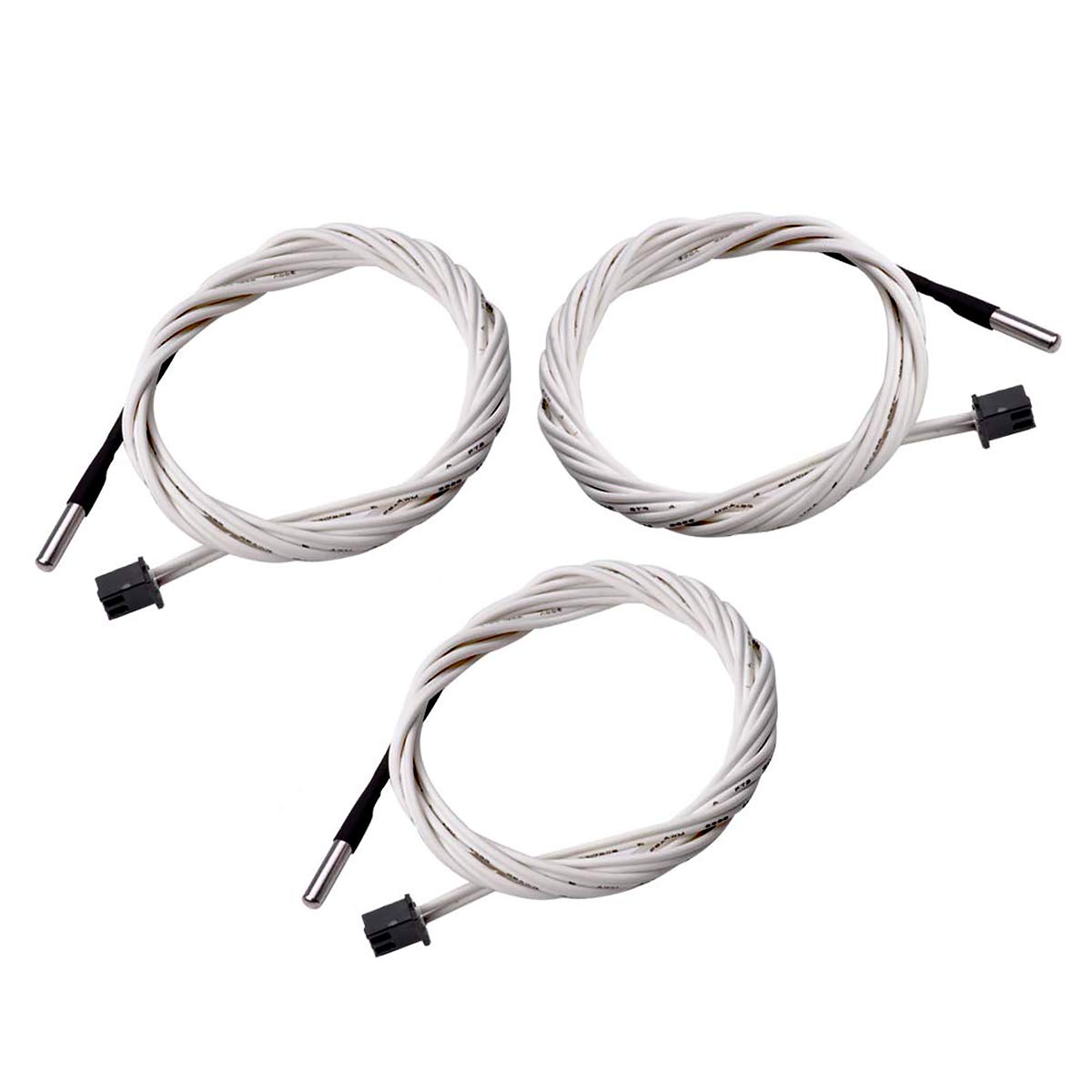

Sorry, left out one thing: Any 100K 3950 B NTC thermistor; that’s pretty universally used across these printers. And you want the whole harness, not just the thermistor itself, I’d suggest; what they are selling on that page looks like just the thermistor and you’d have to solder it to the wires. Here are some examples of the kind of thing I’m recommending:
By contrast, what won’t work with your hotend is this type:
When you get bored and want to upgrade the hotend, you can get one that takes the canister thermistors. :relaxed:

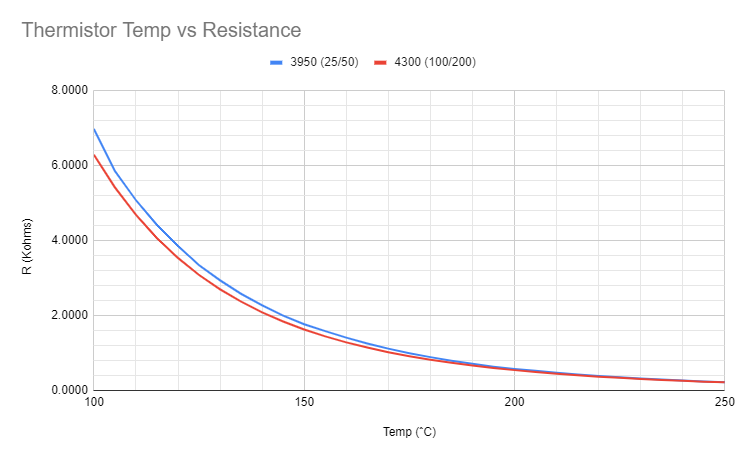

The PT3-25E2-S2 is a NTC thermistor made by Shibaura Electronics Co. From the company catalogue I found that the standard resistance at 25 ºC was 98.64K ohm, essentially 100K ohms. They also gave B (25/85) and (100/200) values of 4066K and 4300K respectively.
Shibaura also provided temp vs resistance data relative to the B(100/200) value. I also looked up data for a typical 100K 3950 thermistor and compared the two from 100-250ºC.
For above 150ºC they seem to be in pretty close in agreement, which is the range for a hot end you would typically be interested in.
I am wondering how 3D Printers are programmed to calculate temperature data. If they are going off a Beta value then I would hope they are using a value that covers the expected use range. Using a 3950 value when it’s calc at (25/50) is going to have a lot more error in the calc value outside that range.
Given all this, I think you probably could indeed use a standard 100K 3950 B NTC thermistor in an A10 hotend.
