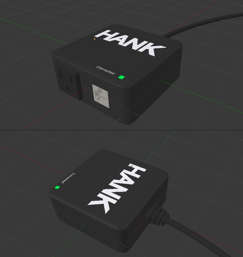

The case for the prototype:
The guts of the prototype:
