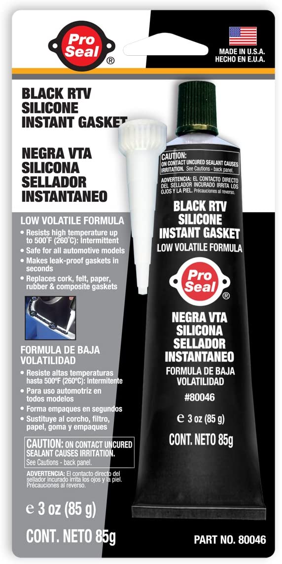

is this any good?

ok thanks for the advice I’ll give it a go. Does the above silicone look like it will do the job?
I can’t find the specs but I think it will be fine. In this case more silicon is better. Use the largest diameter tube in the order of 1/2" you can and insure that it extends at least 1" from the joint (2’ would be better) on each side of the joint.
