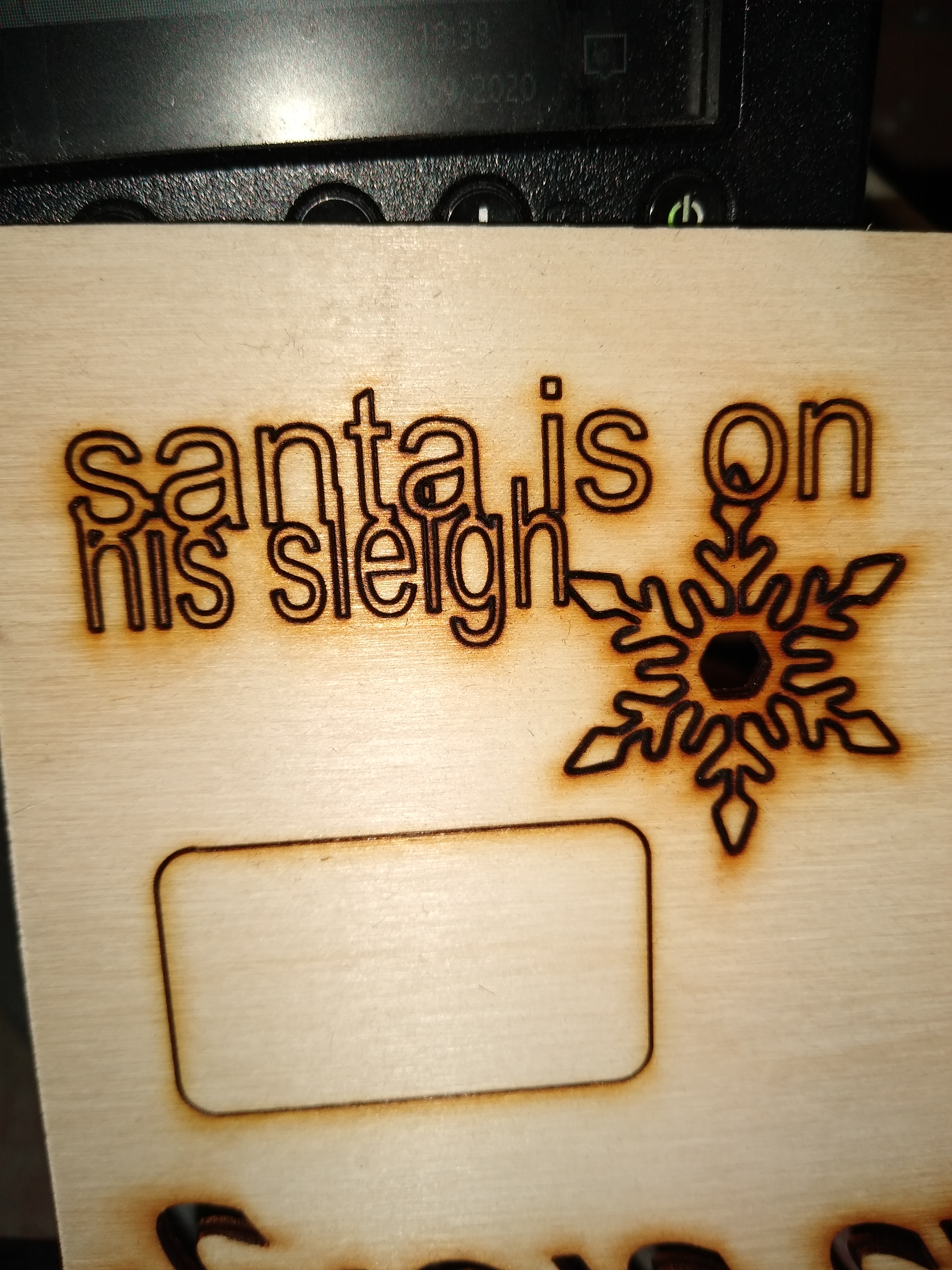

hi im trying to do a design , it is mainly lettering but i want only the outside to cut , when i run the laser it cuts out all the middle bits , im trying to get the opposite , can anyone help or even understand what im asking

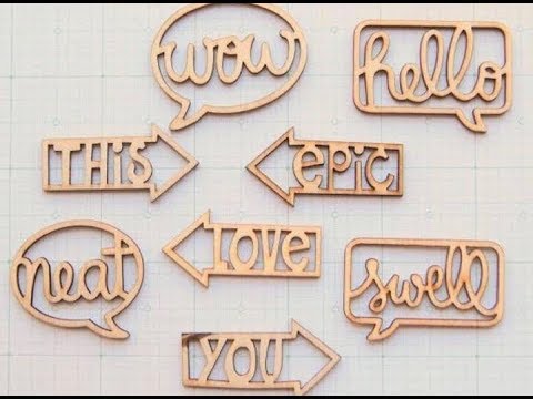

I don’t have the actuall svg file but please see attached

So you are looking to recreate the Santa treat product shown in the picture?
You had tried to cut something you posted in a prior picture (stanta is on his sleigh). Do you have that file?

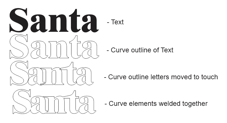

I think you want to know how to join the letters and then cut them out. This typically requires you to convert text to a curve outline of the text, move the curve letters so they overlap and then join/weld the curve letters together. Note that “curve” refers to a type of graphical element.
I don’t work in inkscape so I can’t really explain exactly how to accomplish this in inkscape. Try googling " How to Outline Text in Inkscape"
Yes but when I do it , I can only get the inside to cut , like on this example attached
You have to make sure that your text is attached/overlapping to each other and that all text is attached to the square frame below. For example, the “A” in “Treat” is not attached to anything.
Also the inside of the letter “O” is not attached to anything. So it will still fall out, even if you attach all letters to each other. You have to add some small connections from the outer circles to the inner circle of the letter “O”. Much like stencils.
You also have to union everything. Otherwise it will cut out every letter separately. In the end, you cannot have any lines overlapping each other.
