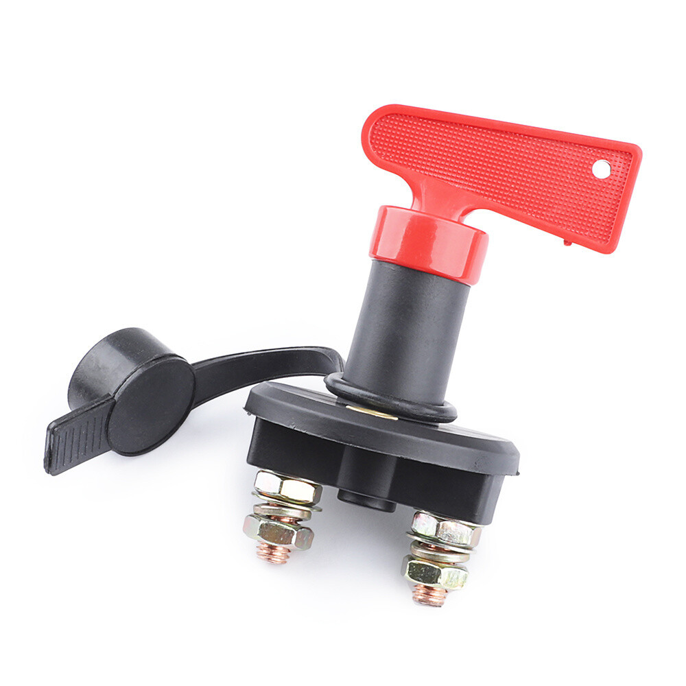

The cheapest/easiest would be two of the very cheap battery isolators you can find in most car/boat/hardware shops:
Then just have a single key available with the scooter, so only one battery pack can be engaged at a time.

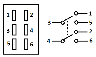

Thank you for your suggestions re battery change over switches, but a pal of mine came up with a great solution, right off the bat, a DPDT toggle switch. Double Pole Double Throw 6 pin switch. Pins 1 & 2 are battery 1 and pins 5 & 6 are battery 2 with pins 3 & 4 being the supply to the scooter control board. An elegant inexpensive solution.

@DuncanC is there a fuse or breaker on the battery line which lead you to the 20A rating on the switch?
If your scooter doesn’t see 20A then that’s a very nice solution but watch out for the spade connectors if you soldered them because they’ll likely break at the solder joint. Far better to crimp.
Just don’t flip that switch while the scooter is under power! :smiling_face:
I don’t know whether you already know this, but better safe than sorry: Switching DC with meaningful current flowing through can weld the switch because there are no zero voltage crossings (as with AC) to quench the arc.
I can’t imagine why you would switch while running on purpose, but you might want to arrange the location to not be easily able to do it by accident.
