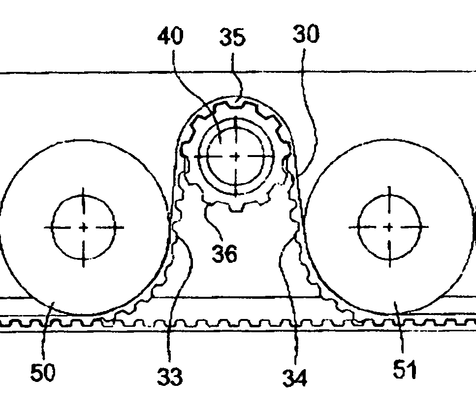

basically its following this idea here
by using dual belts with lower one being fixed to extrusion with teeth facing up. It allows the second belt on top, being placed in a normal manner to lock in with the lower one and increase accuracy by …a lot.
My problem is as it can be seen in 3rd image I am not sure how to fix the belt ends to a machine. This setup in 3rd image doesn’t really tension the cable since it just clamps it.
