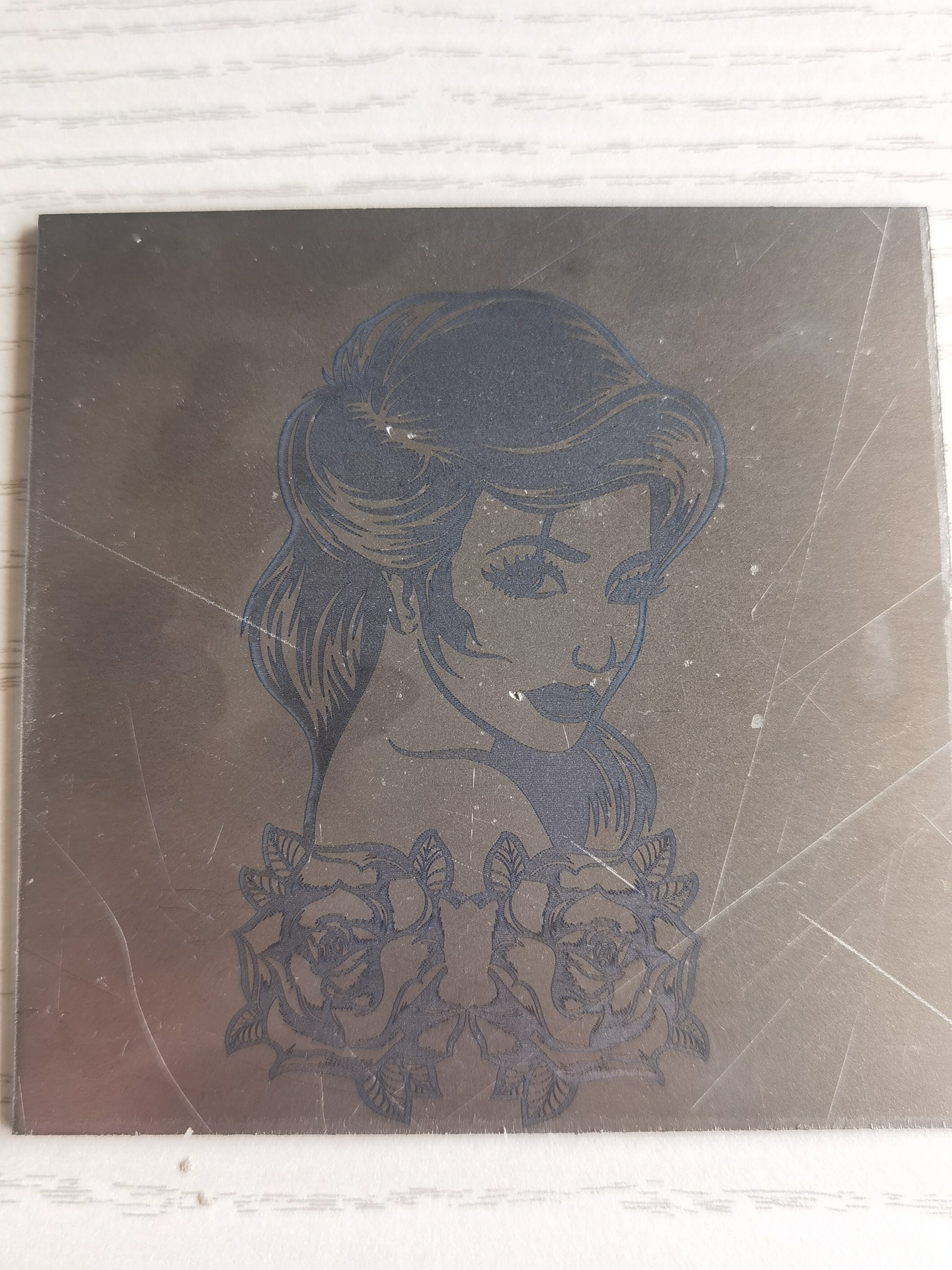

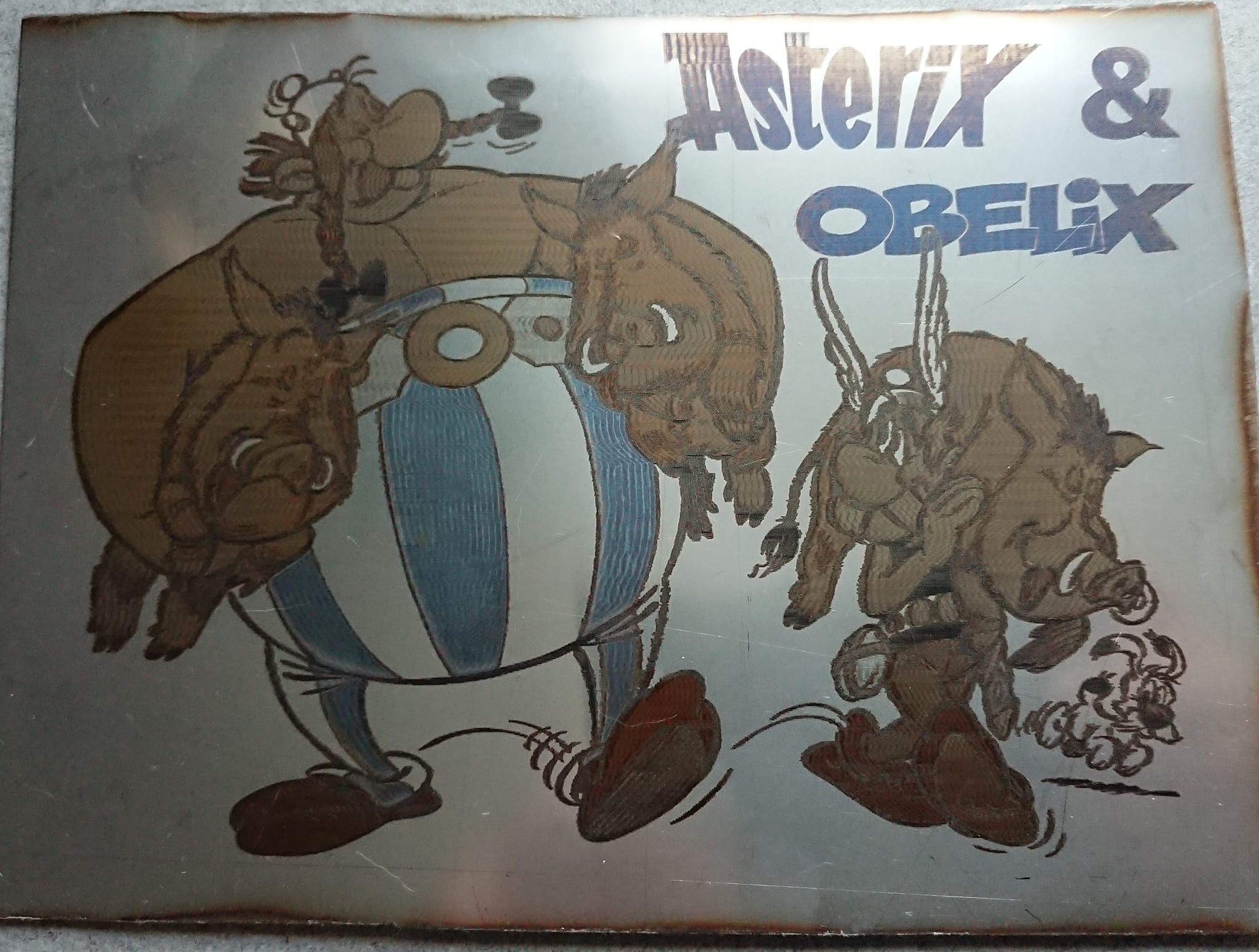

:zipper_mouth_face:Hi everyone, I hope you are all well, I just wanted to ask if you guys know what this material is? Why can’t I engrave such an effect with my 20w module? My laser machine is ZBAITU Z40. Before that, I tried to use stainless steel and titanium alloy plates, and also tried a variety of different engraving speeds. Can someone help? me? I can’t find any information about it on YouTube. .

ZBAITU didn’t mention that they can achieve this effect on the product page, but I saw that ORTUR advertised that their modules can carve this effect, I think it’s also 20W why mine doesn’t work… I also tried over titanium … but its color is very dark and monotonous …

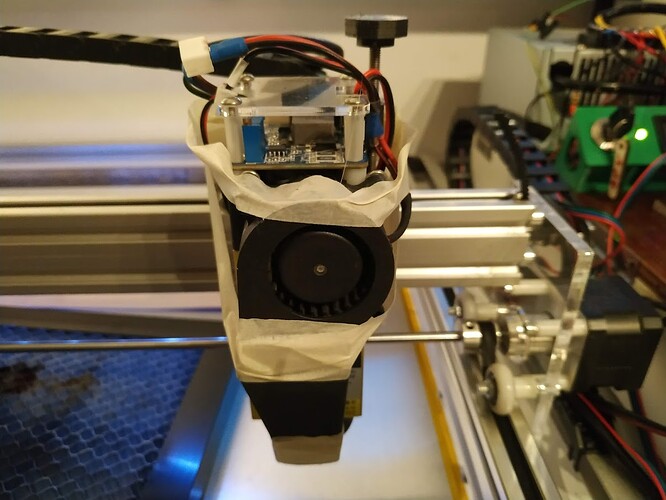

It’s possible that the Ortur has a more tightly focused beam with a Fast Axis Collimator (FAC) lens.
@easytarget wrote some really thoughtful comments on those laser heads:
So I could imagine that the very best diode laser heads with very thin Ti sheet could produce colored output. Given that this is oxidation, I could imagine air assist helping provide enough O2 rather than blowing away smoke for this use?
But the cost for those best diode lasers as a system starts to get close to the cost of the least expensive Fiber Lasers which I’d expect to do a much better job here.

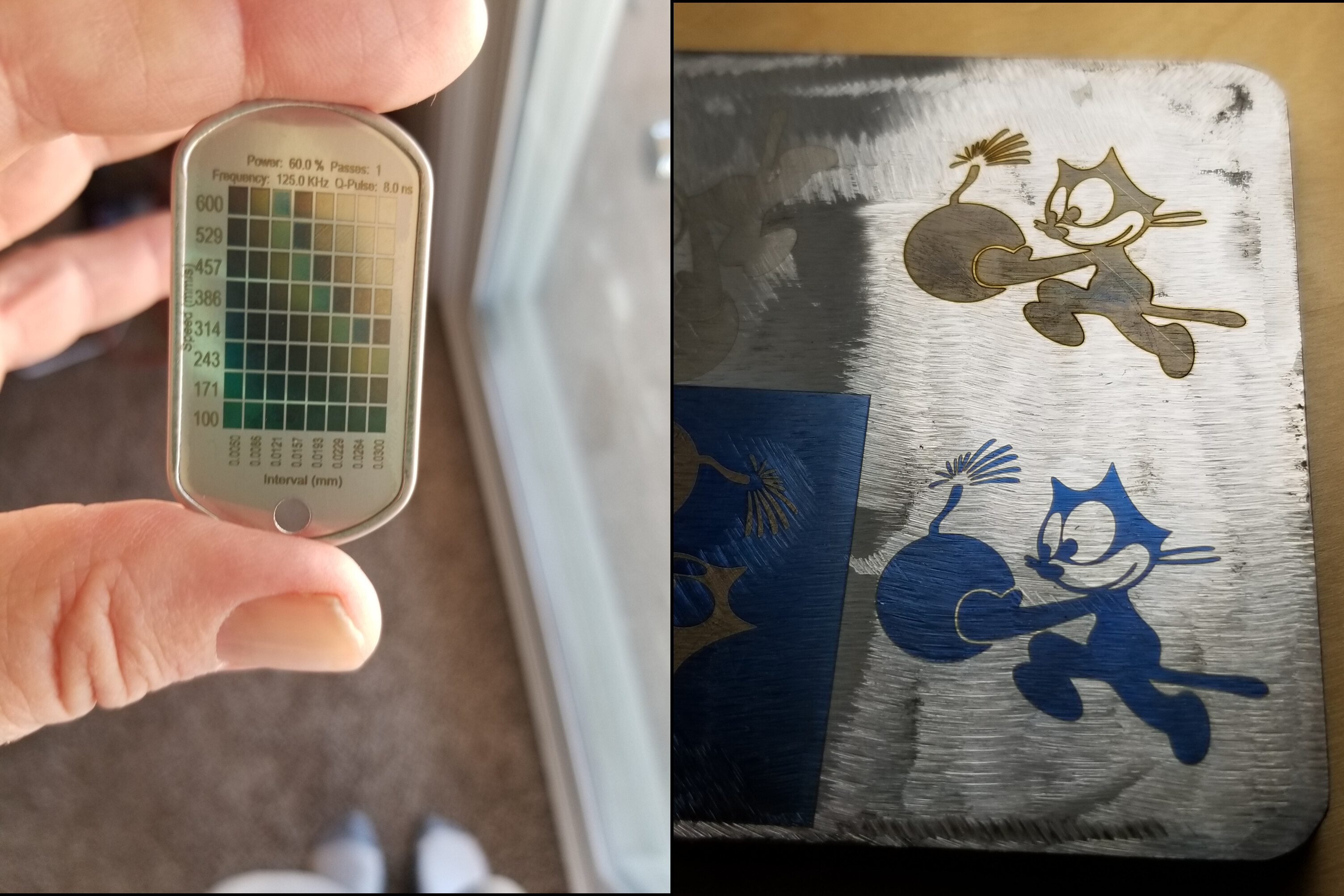

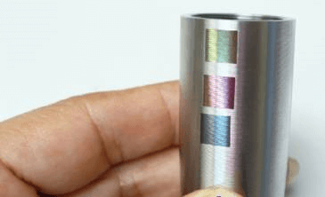

In the real world when you have to or want to do this… it’s not so easy… I have a 60W MOPA fiber laser and there really little out there that helps you ascertain what color for a specific setting…
Dog tag is thin, same values don’t work on anything that isn’t the same type/thickness of metal, this is a link for just stainless steel .
On the right is some scrap 1/2 steel, managed to get blue out of it… :face_with_spiral_eyes:
I have a number of these that just disappear when the angle of the light changes… putting them somewhere they can show off is difficult. Did a mug, the image looks like it’s banded unless you roll the mug and the bands stay where they are…

The different colors are for different oxidizing/annealing caused by the beams excitation. If you laser doesn’t create enough heat, you may never be able to reach that temperature, as the metal conducts it away very fast.

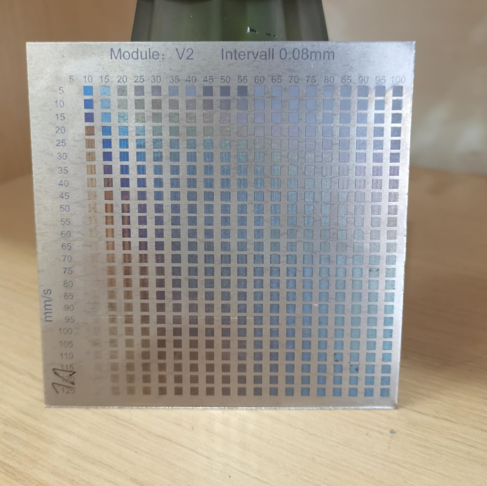

Laser metal color engraving is possible, but it won’t be very colorful.
You can try testing with this Lightburn file.:point_right:LT-4LDS-V2 titanium color engraving file

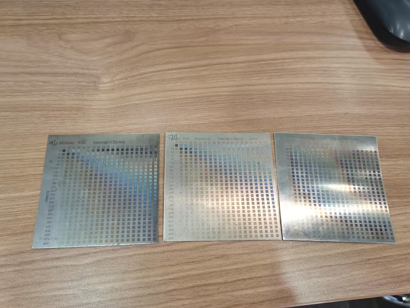

For metal material, we suggest you choose matte material 0.2mm thickness or more. High power laser module for long time engraving too thin material may bend. If your laser module is not designed with reflective protection inside, prolonged engraving on glossy metal plate will directly damage the internal diode due to the refraction of light.(As long as the metal material that can reflect light, without reflective protection there is a probability of damage)
From left to right are pure titanium alloy,titanium , stainless steel. The optical power of the laser module is 30W, and the engraving machine is Ortur LM3. The color performance of pure titanium is better than stainless steel.
