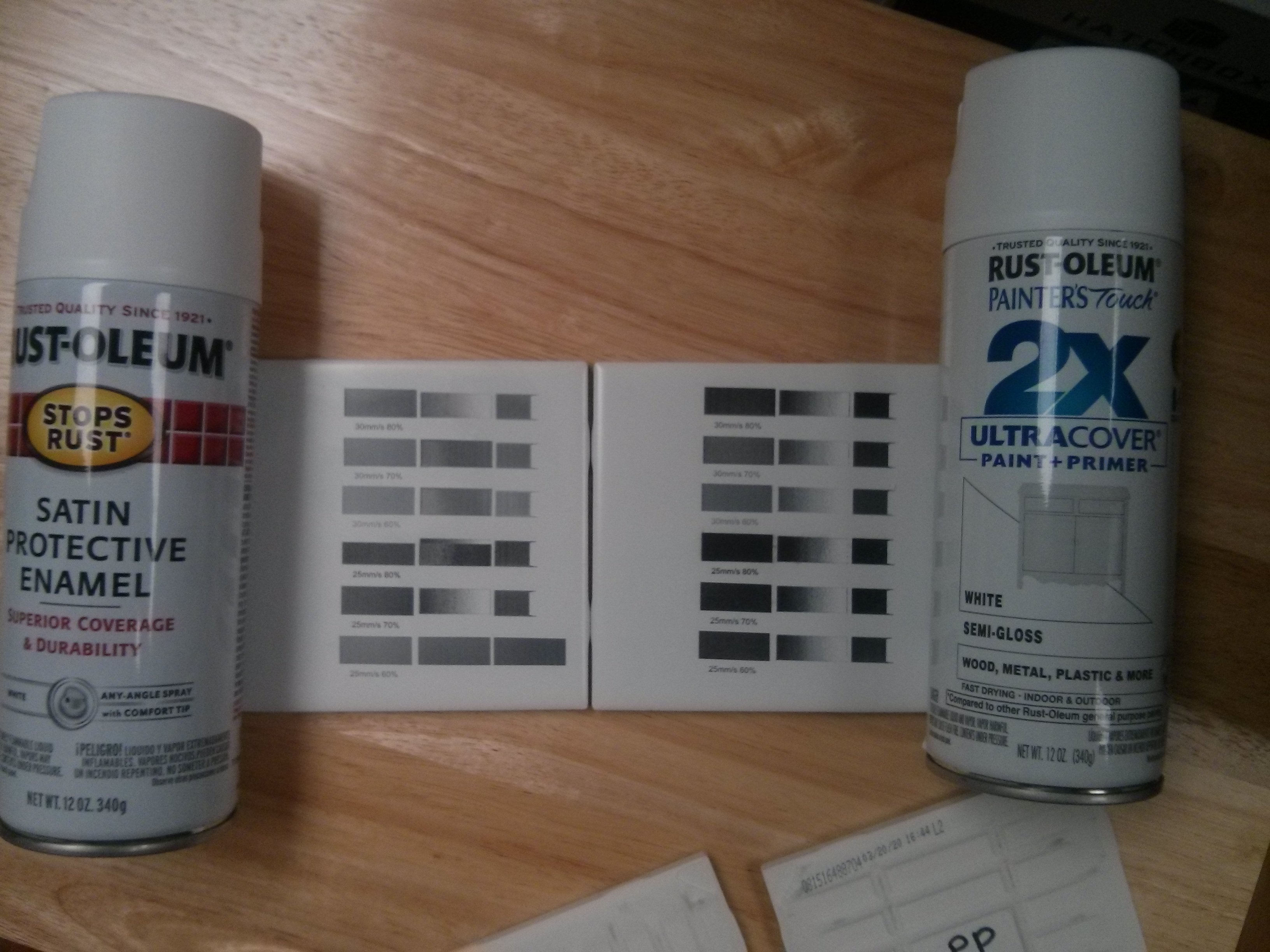

This might explain what was going on when I was doing a test pattern of dithering and grayscale on white tiles and my grayscale patterns went from white right to black instead of the gray scale and I’ve been using dithering ever since.

I showed the tile testing because that’s how you figure out your best power/speeds for the colors you want in your design and in this test, the rectangles on the far right column were grayscale and you can see they are black and then go to white when they should have been graduated gray scales. I think I was running at 5KHz base PWM frequency to the LPS.

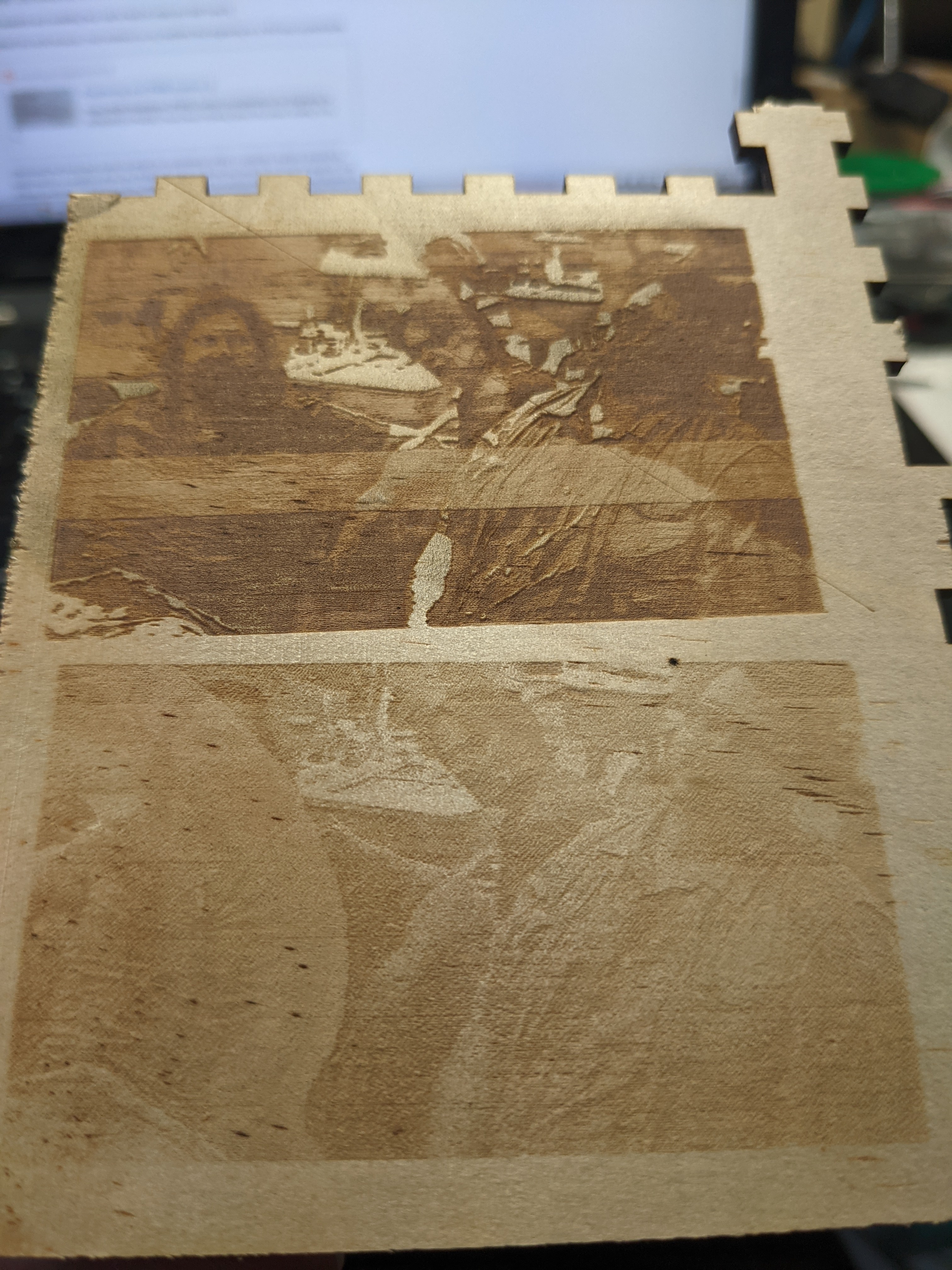

I have LinuxCNC/Remora engraving on my K40 having done both dithering and grayscale on an unedited image(LightBurn changed to grayscale only ).
I also did a quick/dirty test of changing the PWM period from 200uS to 400uS and it can be seen in the light band in top engraving down towards the bottom of the image.
The bottom engraving is using Stucki Dithering 5% power 200mm/s 200uS(5KHz) PWM pulse period.
The top engraving is using Grayscale 10% power 200mm/s 200uS(5KHz) PWM pulse period and short test of 400uS(2.5KH) pulse period changed dynamically during the engraving.
