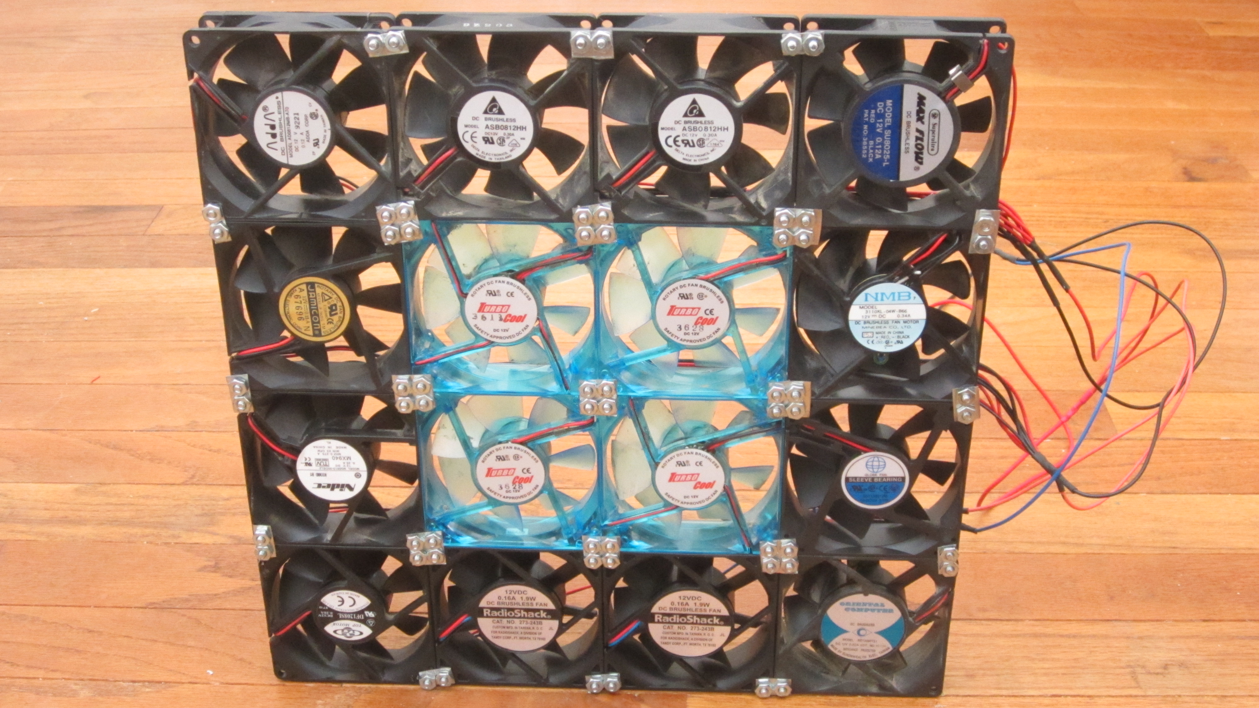

So I found a video on YouTube, this is kind of what I’m looking to do, PC Box Fan - YouTube
But, I’d like it to be portable, with a rechargeable battery, and can also plug into the wall, DC right?
“It can be powered by your computer’s power supply, an AC adapter, or a 12 volt car battery”

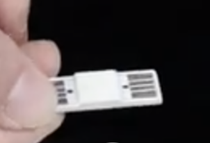

Does anyone know what this component is called? I’ve tried googleing USB double male… but nothing. Cheers.

Where did the picture of the male=male connector come from and is used for?
