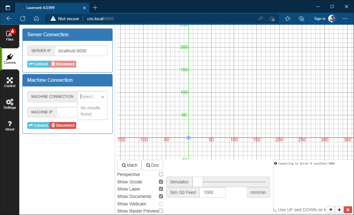

Problem description
When I view Comms > Machine Connection, I expect to be able to see the serial/usb port on my Pi, but instead nothing is visible in the Machine Connection dropdown.
If I connect to the controller directly from my desktop PC with LaserGrbl, it works fine.

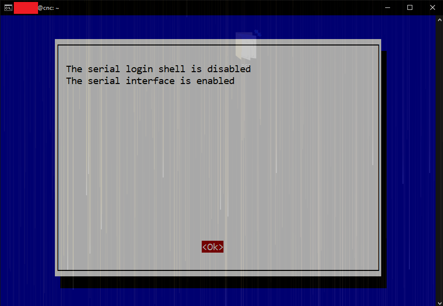

I’ve enabled the serial interface via raspi-config (screenshot below). I’ve also run npm install serialport after seeing it in another support message.
I’m quite a n00b with Linux and the Pi world, so it’s highly likely I’m missing something obvious.
Can anybody help with ways to get my Pi Zero 2 to expose the serial port which my CNC/laser machine is connected to?

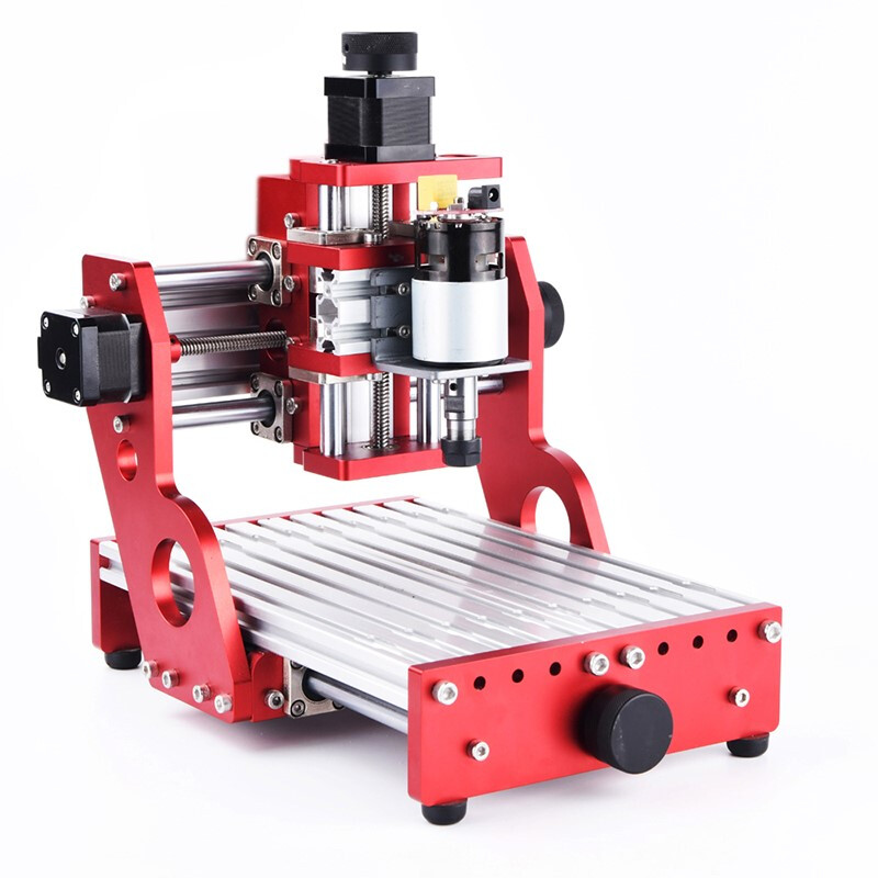

  • My machine is a diode laser + mill (image below)

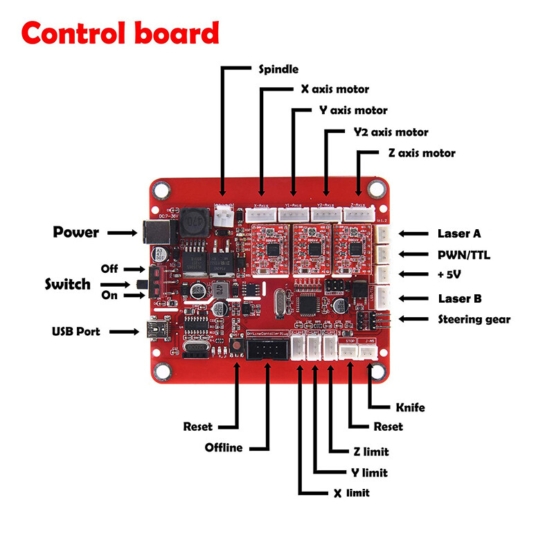

  • I have a mystery Chinese board which accepted the grbl firmware and works find with LaserGrbl directly connected to my PC. Images below of the rig + controller board.
  • It has grbl version 1.1h installed
  • I connect via USB | Serial using ??? ← this is where I think my problem is rooted.

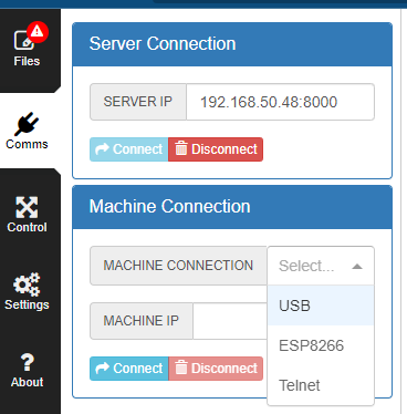

I think the problem is much simpler: Your frontend is not connected to the Raspbery Pi!
In the screenshot I can see, that the server IP is configured as “localhost:8000” which only works when the frontend is run on the same PC as the backend.
In your case I immagine that the backend runs on the Raspberry Pi Zero 2 and you start the frontend on a differnet PC over WLAN/LAN. In this case you must change the server IP to Raspi-IP:8000 and then hit connect! After that you should see the available USB Ports.
Wheyyy heyyyy!!!
I think you might have nailed it! I had assumed all along that since the web server was running on the pi, that the connection would be from perspective!!!
Now lets get this thing burning!!! :smiley:

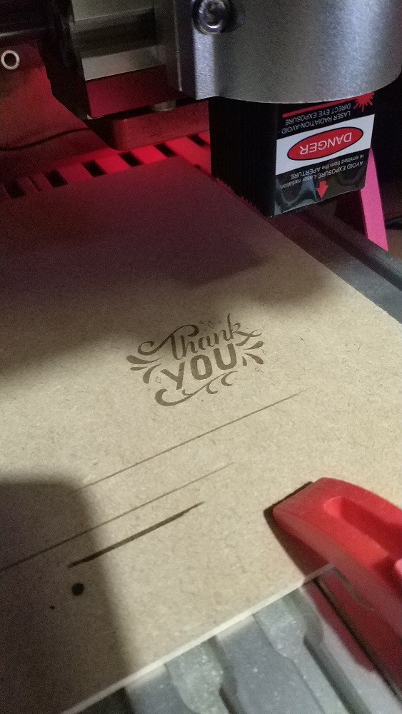

First burn is for you guys!
(Or actually, the 5th, as you can see attempts 1-4 didn’t go quite to plan, but got there eventually!)
