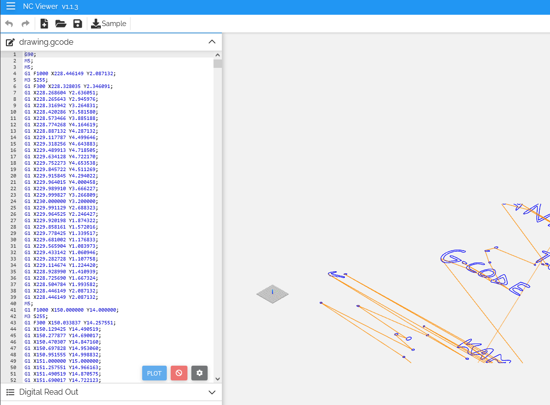

I’m gonna use pySerial to send gcode to arduino from python but my gcode is displayed wide when i visualize it.
I see on some commands like this (G1 X228.268604 Y2.636051;) the X is too big for my plotter.
I can send to my plotter to move max X95 and Y95.
like you can see here:
If using some interface like universal gcode sender it may be possible to add some settings(bed size) to fix that but i would like to send the codes line by line with python, so using pySerial.
Do anyone have an idea for down sizing the gcode to fit to my plotter (US Leter format or A4)?
