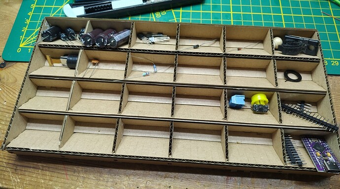

Here’s what the current project looks like:

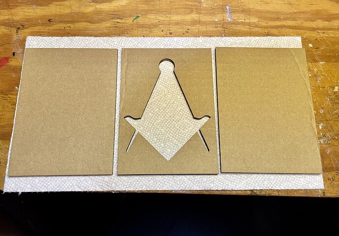

We also have an interesting thread where a member does exactly what I need with a laser:

@easytarget how long did it take you to cut that fairly complex pattern you posted on Social with a cheap diode laser?
I could imaging that one of the new focused diode lasers could cut fairly quickly with narrow kerf, given some of the results we’ve seen people here share with wood?

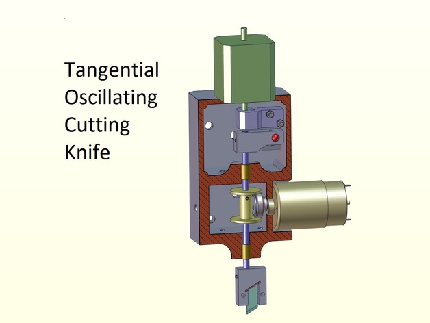

I completely forgot that Brad Collette was talking about working on an oscillating tangential knife design some time ago! That would make sense. While those are normally steered, I seem to recall someone in the conversation, probably on Twitter, bringing up the idea of a free pivoting OTK.

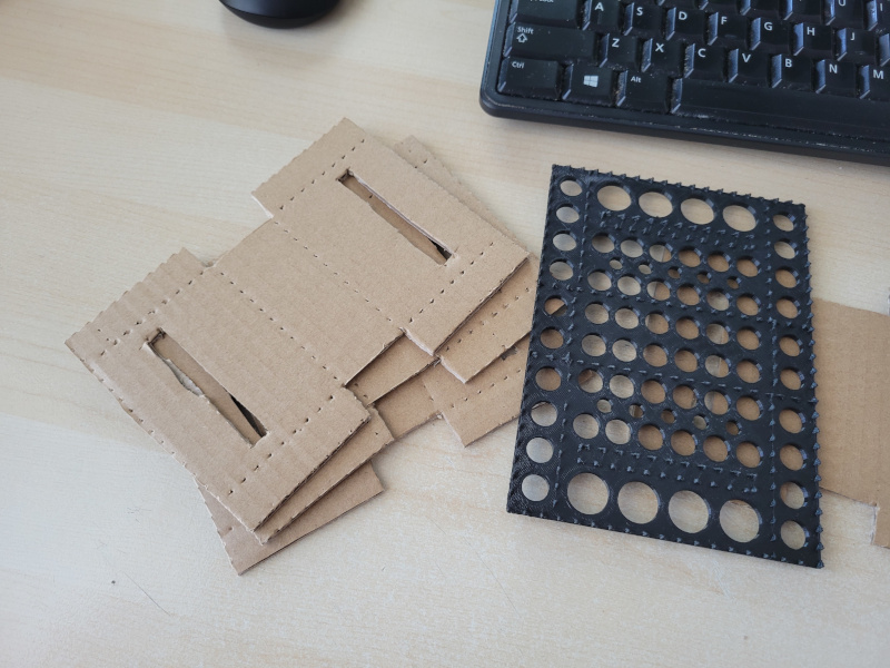

I decided to go with printed blades for now. I made them twice taller than in the lead photo in the thread, about 6 mm. I found quickly that doing so made it quite uncomfortable to push the cardboard on them. What to say about embedding exacto-knife blades!
In fact, the original was made with the intention of one-pass cutting and creasing. It may be not too obvious in the picture, but the teeth have 2 heights. Pressing into that was no picnic when teeth turned into blades.
So for now I made a set of 3 printed plates: 1. plate with cutting blades, 2. plate with creasing teeth, and 3. plate that is used as a bucking surface, to save my fingers. Honestly it works so-so, but unfortunately I don’t have the time to go through and re-invent a EOT head for the 3018, like the one Michael linked off Thingverse above.
