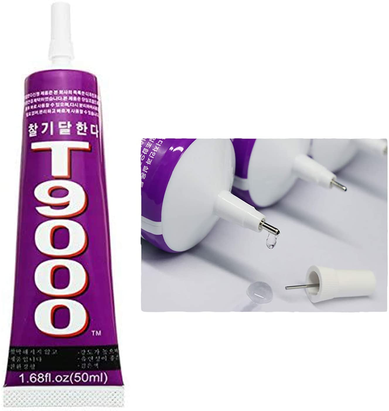

It seems I can’t find any of the references you suggest. What do you thinkabout this one ?
It says:
[Characteristics] - It is a transparent glue that is odorless, non-corrosive, not white, not brittle, not yellow, not hardened.
[Type of bonding material] - Ceramic, glass, leather, plastics, electronic components, metals, stone, rubber, wood, acrylic, etc.
Temporarily out of stock. :disappointed:
