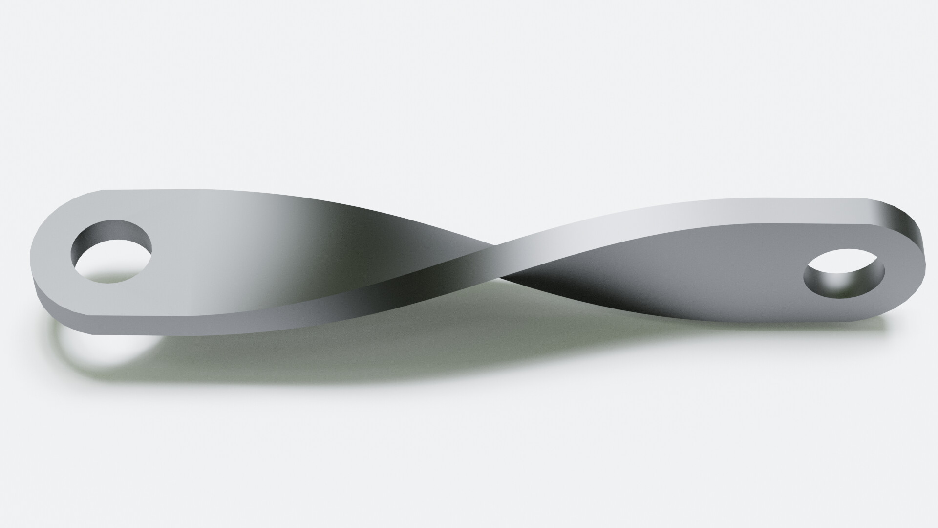

How would you turn this drawing as a 3D part?
This part has shown up in a few demo’s and there have been lots of ‘why would you use that tool’ or ‘why would you design it that way when in X it’s just a single operation’, etc.
So how would you design this as a 3D model? Please list the software and general overview of the techniques used.

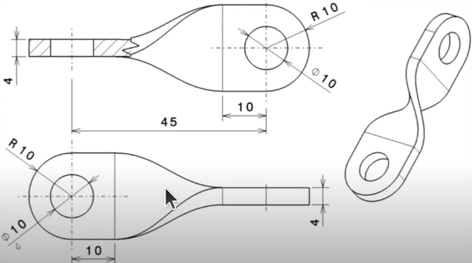

I can’t tell from the image. Does what you did in Blender account for the 10mm from the center of the hole before the twist starts?
Yes. I used the end of the bar (circle area) as the handle to start the twist for the middle of the bar.
I don’t normally model this way so I am sure there are better ways to do it. There are multiple ways to do this but this was the fast and dirty way to do it.
It would probably be more apparent if the distance between the hole centers were 45mm as there probably would be been more visual clues that the ends were still flat.

No wonder it looked weird to you guys. I misread the diagram.
I thought the distance from center to the middle of the bar was 45. So my bar is 90 center to center. But other than small hiccup the process is the same. It only took about 2-3 minutes to model.

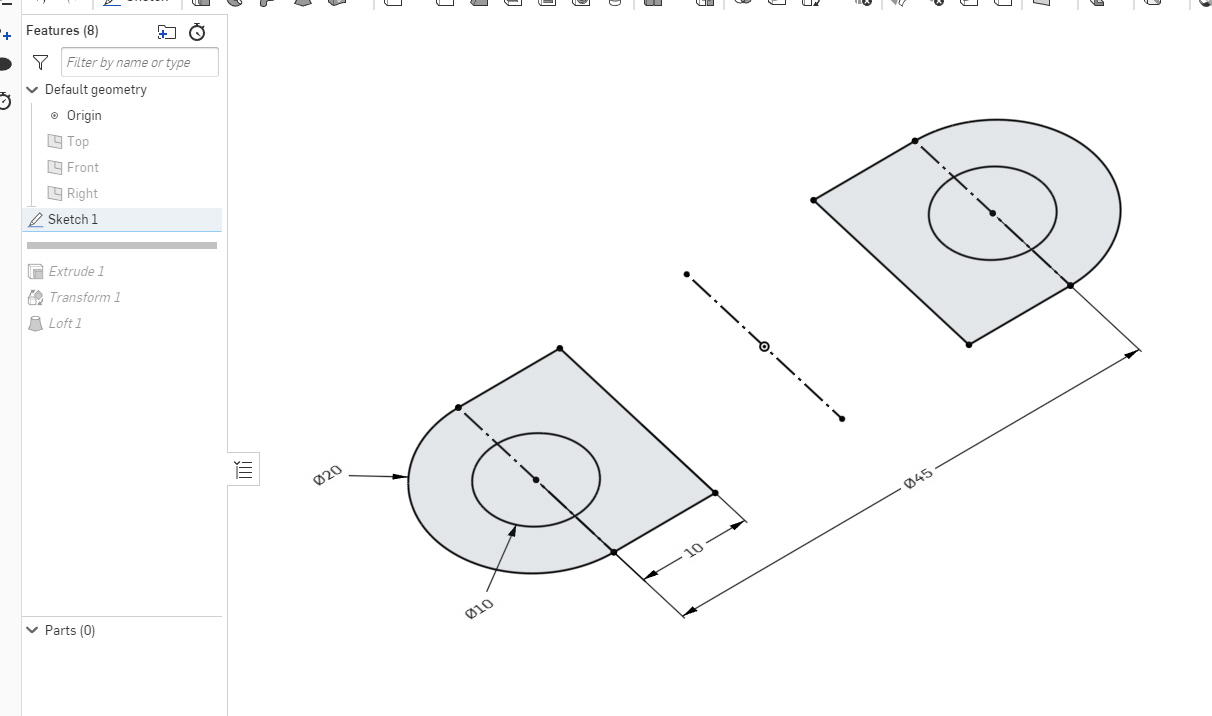

I gave it a try using Onshape. My process was:
  • Create a sketch for the flat part of one end. Mirror that drawing within the same sketch.
  • Loft that sketch (which creates two parts)
  • Rotate one of the two parts 90 deg.
  • Loft between the two parts (merging them at the same to end up with a single part)
In the loft “Match curvature” (or should it be Match Tangent??) needs to be set for the start and end profile, and the one tricky bit is checking on Connections and picking two edges (or points would work too) that should connect together. This seemed to be the key that allowed it to know to “twist” the loft.
This is what it looks like if the Connections bit is Not toggled on. It just lofts “straight” across.
