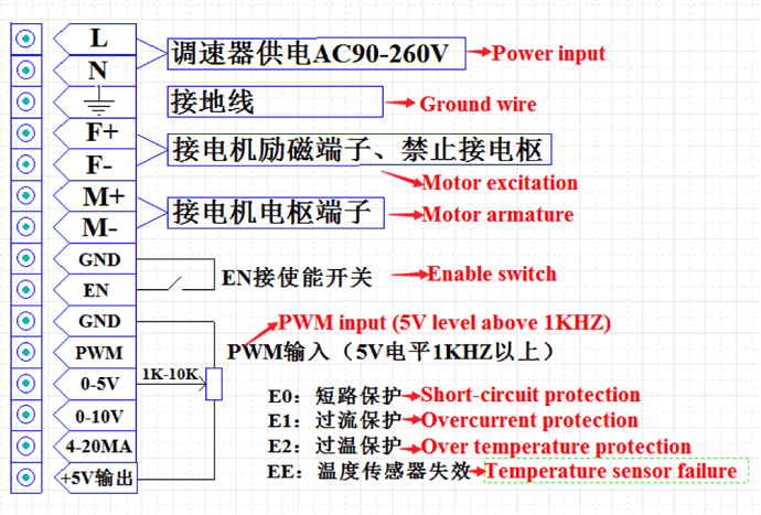

I have an HQ-SXPWM-A 110V spindle power supply in the OX I’m building. It turns on but always runs the spindle regardless of enable or voltage range input. Information on this unit is hard to find, and I have no instructions beyond what I found on aliexpress:

  1. With flexible multi-function interface
With it powering the spindle regardless of the enable setting or any input settings, I’m worried that I have a dud. I guess I can just run the spindle at full speed (or whatever speed it is actually going) for now…
It’s providing 155V to this 110V-rated spindle. Probably not doing the brushes any favors. Pushing the switches through the case with a bit of plastic, it’s clearly set for 110V and 8A; the default settings. So I think it’s dead inside somewhere.

Then, recently, I decided I might want to use the old spindle to make a tool post grinder for my lathe. I rummaged through my power supplies and found two. I decided to test them on the bench. The HQ-SXPWM-A didn’t honor the potentiometer or the enable switch. I did a search for information on it, and Google brought me back here to my post from almost four years ago
So now I know I need to use the other supply! :grin:
