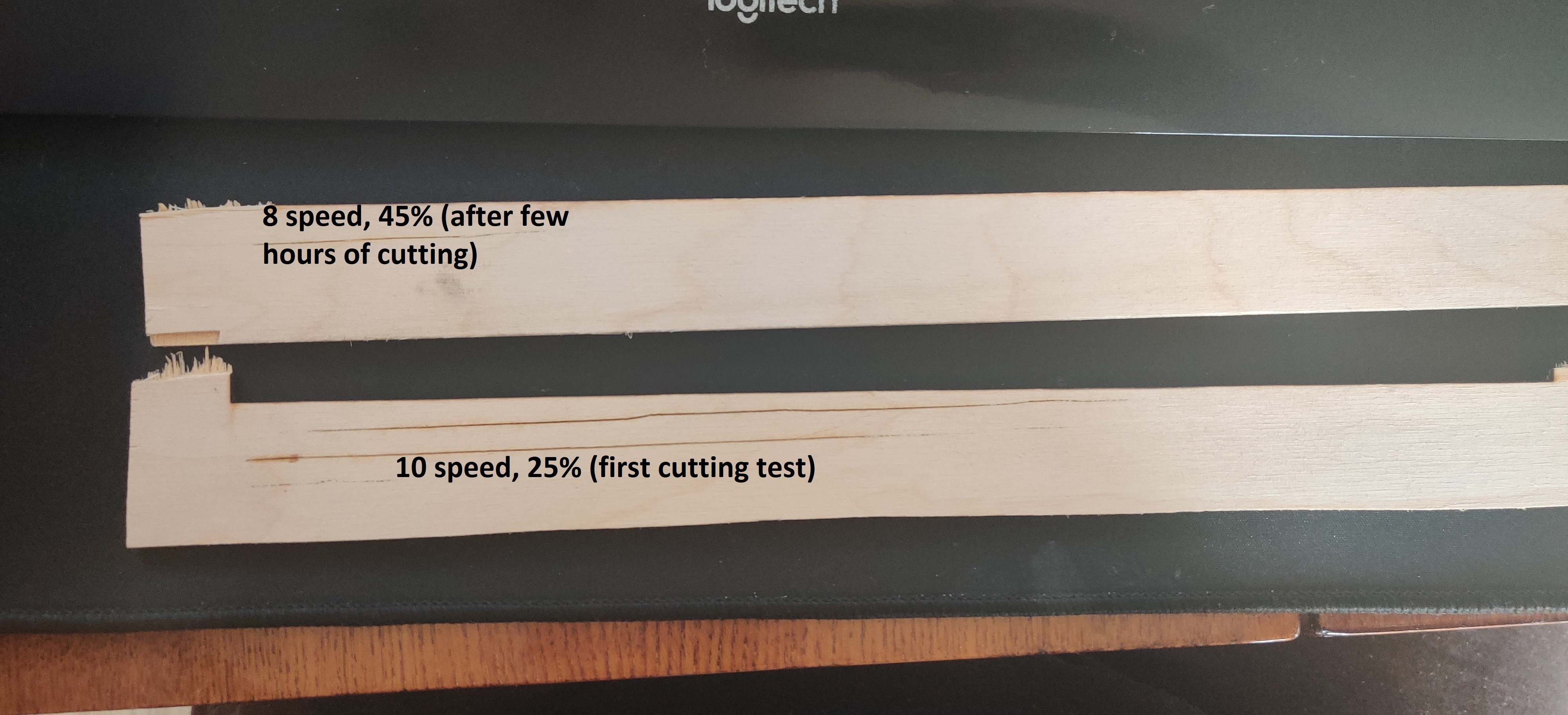

I have rebuilt my k40, new tube, LPS, mirrors, and lens.
After replacing the tube first cut was amazing 10 speed, 25% cutting through easily. The next day it started cutting, worse, and at the end of the day it stopped cutting through.
Also there is small bubbles in tube, after a bit of running its turn into bigger bubbles.
