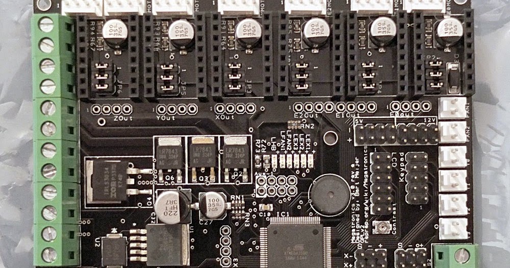

I think the megatronics v3.0 from reprapworld might be for you. Check it out. :slight_smile:
@Hrvoje_Cop_chopmeist thanks. Looks very similar to the azteeg x3. I am tempted.
NP, glad to help. I did write a bit about it here:
so maybe it will help with your decision.
@Hrvoje_Cop_chopmeist funny I was already reading your article when you linked it. Looks to be about the best rundown on the megatronics out there.
