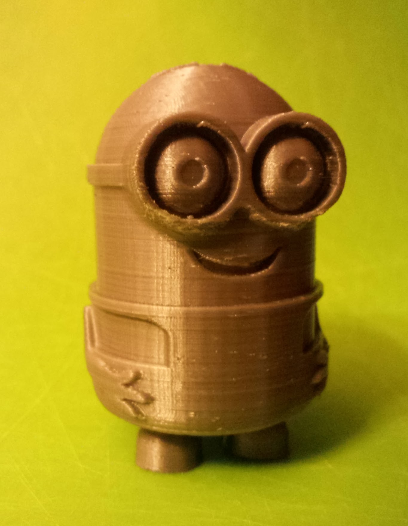

I finally have PLA figured out. I have been fighting PLA for a month.
I finally have PLA figured out. I have been fighting PLA for a month. I would always jam around layer 30 or 40.
The trick was a good propane burnout of my E3D, and running filament dripped with Canola oil through the E3D back and forth while cold and off the printer. Now I have run half a spool of the same PLA with zero jams. I can crank the print speed up to around 100mm/s with good results.
I also moved the spool mount from on top of the printer over to the side. I used a $2 garage bike bracket and a few feet of 1/4" nylon tubing to guide it to the extruder carriage.
Lastly I tried my first print with support. I still have lots to learn about improving Cura support settings. But I feel it is not too bad for a first attempt. Cura seems to do a much better job limiting supports than Slic3r. When I looked at the support code from Slic3r it would have been a bear to remove it.

What is your calibration technique for estep/flow, and retraction? also do you keep wall thickness in multiples of your nozzle width?
@Karan_Chaphekar for flow calibration I marked the filament then extruded 100mm at temp with nozzle on at my print extrusion speed. Then i measured the length change and changed the values to match. Retraction is at 1.5mm. Wall is 1.2mm on the dragon print. Nozzle is 0.4mm.

@Ashley_Webster I had to play with the expert setting in Cura for offset of supports in x/y to get supports to look the way I thought they should. Check out the support offset settings when you try it in Cura.
eric, are you please with the corexy setup? any issues have you encountered after switching from Hbot? I really like your impressive prints.
@Melvin_Chen I like corexy over hbot. But long term I think I will be switching to a Cartesian setup. The reason is my circles still have issues. Before I change I will be trying new linear bearings (igus instead of pbc linear frelon) because I saw @Tim_Rastall had similar issues with his linear bronze bushings causing circle issues. But if that doesn’t do the trick I will make the change.
