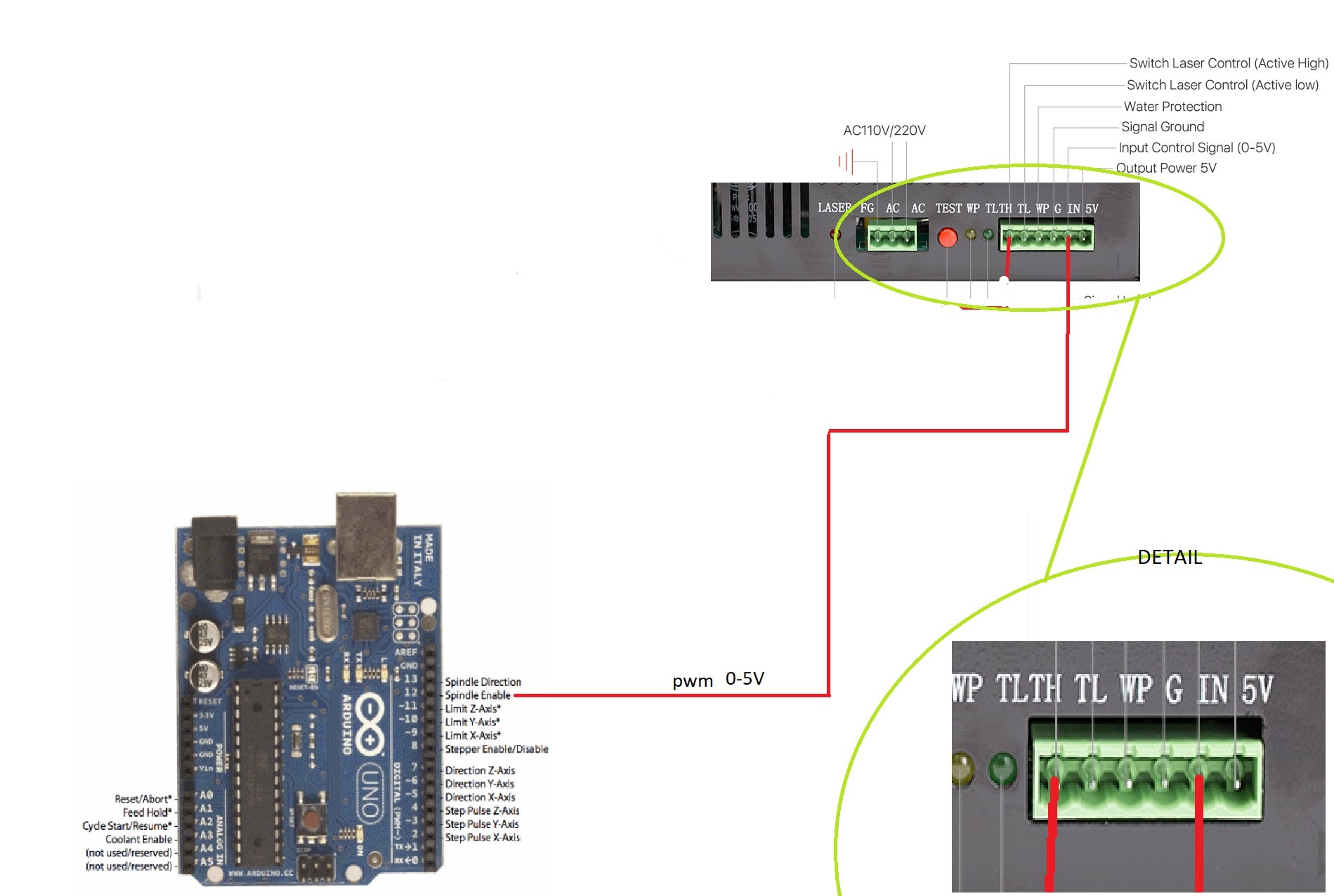

I need help I use Laserweb4 and arduino uno with GRBL 1.1 for engraving.
I need help
Now I want to connect the co2 laser to the Arduino Uno.
Who can help?
If i connect according to this scheme, the laser will work correctly?

Be warned- the laser fires full power at 0 volts and grbl sends 5 volts for full power. You can configure the grbl software to flip the behavior but the laser will still fire for a split second while the arduino starts up. I added a simple transistor circuit (found through this group) to flip the voltage around. Im much happier with this from a safety point of view.

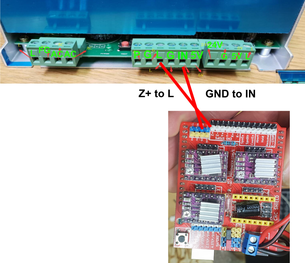

I use arduino uno and CNC SHIELD.
GRBL 1.1 and the program Laserweb4.
I’m trying to connect the power supply, but I can not.
Help solve this problem please

It’s not needed to invert the pwm signal. Just use the TH input of the power supply instead of IN. TH is active high, L is active low.
More precise: TH and TL are activating the tube (digital) and IN is defining the power (0-5V).
You also need to connect the Ground of LPS and Arduino.

@Danilo Please post a picture of your LPS (with cabeling) and the CNC shield, so I cann tell you how to connect. There are two versions of the CNC shield. The old one was made for Grbl 0.9, the new one is made for Grbl 1.1 and don’t need to swap the Spindle/Z+ pins.
