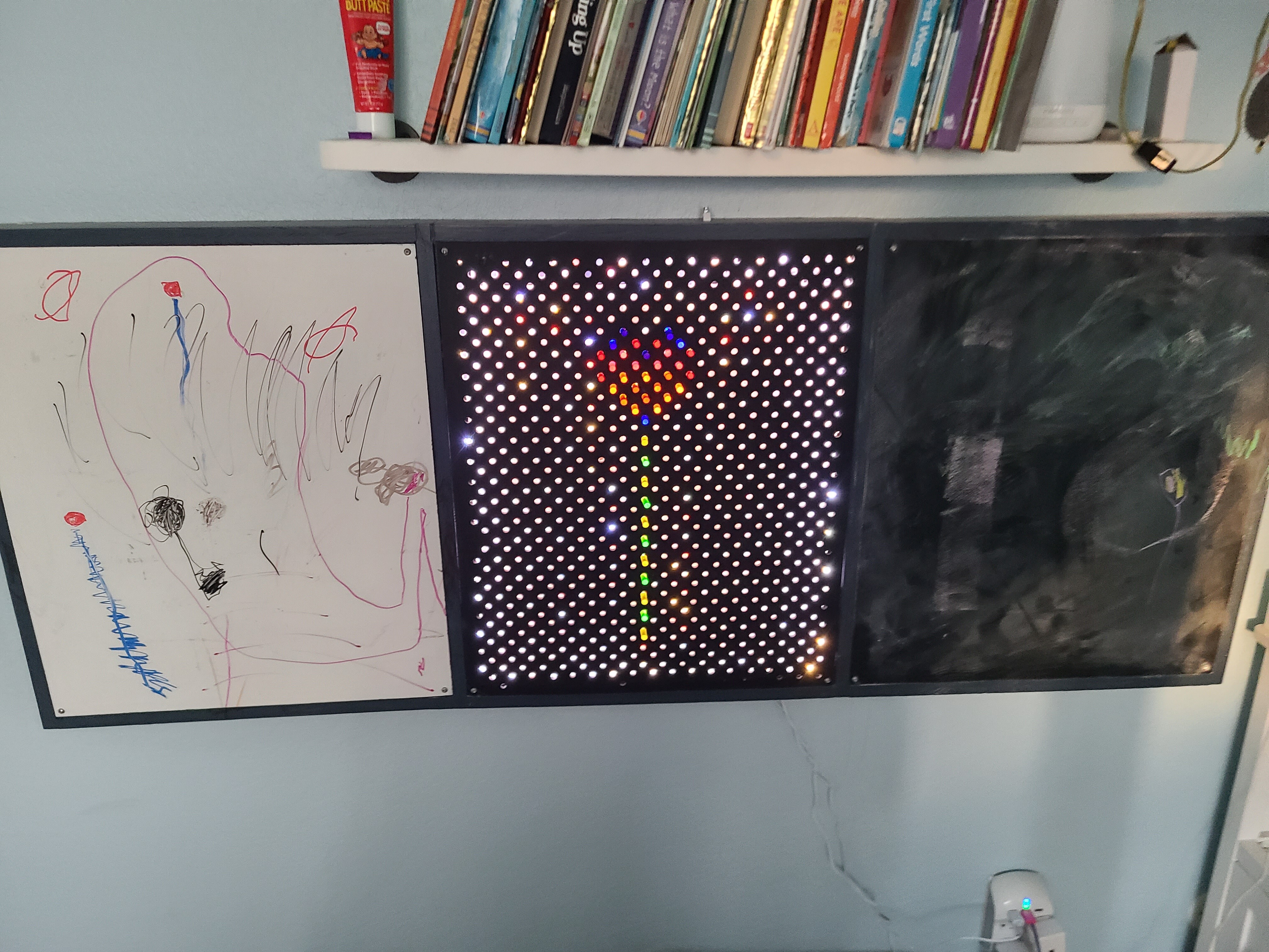

So I finally got around to taping the rods and cutting them. It worked perfectly. I just need to buy 2 or 3 more packages of them off Amazon and cut them the same way. They are for the dry erase / chalk board / light bright wall hanger I built for my daughter. I wanted to line the back of the pegboard with thin sheet rubber. There would be cuts in the rubber for the pegs to push through. It didn’t work out so I ripped it off.
I’ll take more pictures when the sun goes down.
