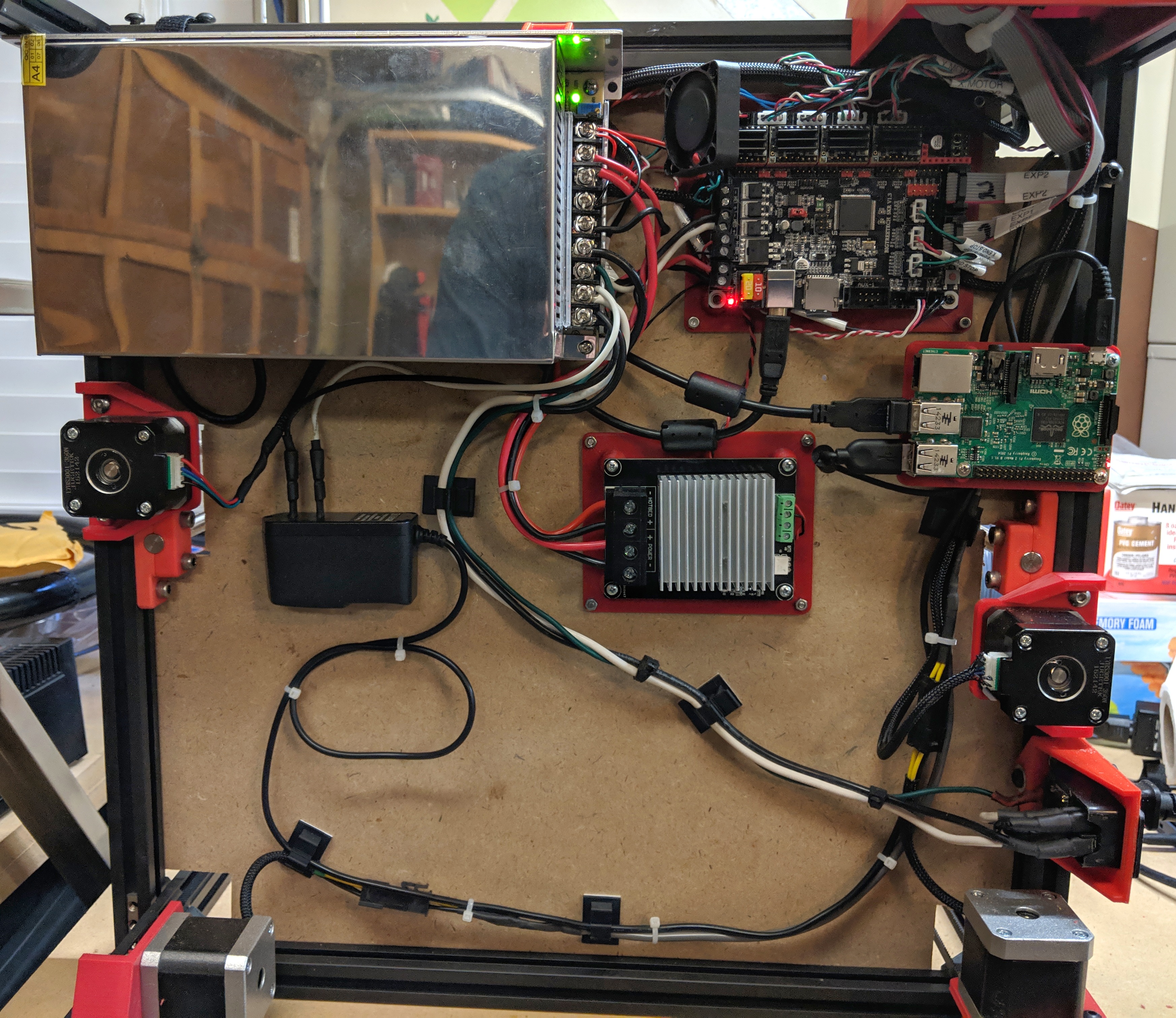

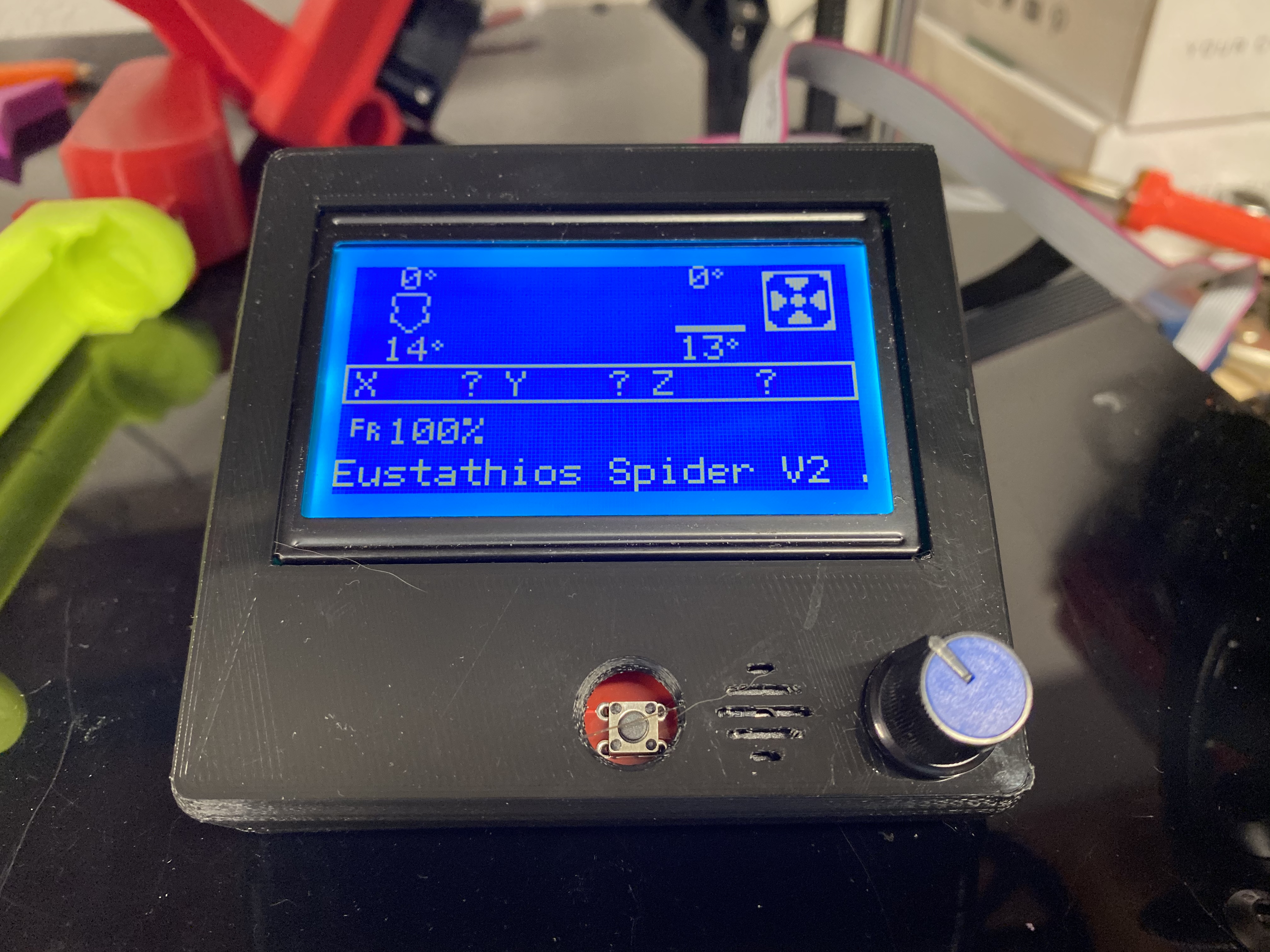

Over the last two weeks I have been playing with Marlin 2.0. I bought an SKR V1.3 board for $20, some TMC5160 drivers for $65, and a RRD Full Graphics Display for $11. After learning platformio to complile Marlin 2.0, and working through a few bugs (had to disable Linear Advance), I am liking the setup. The drivers are almost silent when in Stealthchop2, but I run hybrid mode so it goes to spreadcycle above 100mm/s to avoid skipping steps. I might pickup a BLTouch and design a new carriage just for fun to enable ABL.
I also forgot to mention, the new control board runs off of an LPC1768 (similar to some of the smoothie boards), so it’s a 32-bit controller that uses the new Marlin 2.0 HAL (hardware obstruction layer) setup.

Would you mind sharing your RRD Full Graphics Display stl file?
I am struggling to find it. I will have to check my other laptop when I get back from traveling.
No worries. I think I found something that will work.
Sorry for the delay, I was out and I had it saved in an odd folder that I couldn’t get to remotely. It is up on the Github now. Note my frame is a V1.5 not V2, So I it will need modifications for clearance on Spider V2. I will try to work something up over the next few days. But here are the files for now:
Just noticed you had posted this. Thanks!
I’m getting close to releasing the version 2.5 that I am working on. That one has a better layout for the BTT TFT35 v3 which has the button alongside, versus below. So it fits a lot better.
Ok Cool. I need to get the screen mounted to frame. I had trouble with the wiring and every time I flipped the printer over the screen would go flying. HAHA
