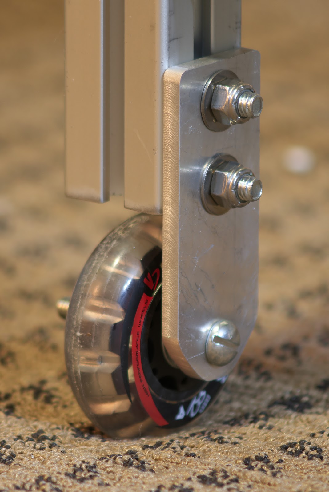

I’m thinking about building a stand out of extrusion stock with some fold down roller blade wheel castors, kinda like those workbench kits where the castors click down for moving this beast around.
I think that @Mark_Rehorst put casters on the back of his UMMD to make it easier to transport.
Yes, I mounted skate wheels (from a pair of skates I bought at a Goodwill store) on my 3D printer to make it easier to move around. It has two wheels and two leveling feet so I can set it up anywhere.
I eventually want to change to larger wheels so I can move it up and down stairs easier- skate wheels aren’t ideal for that.
That’s 40 mm square t-slot, 2x 5/16"x18tpi carriage bolts, 1/4" aluminum plate, and an 8mm or 5/16" bolt through the skate wheel.
If you think about it, 4 legs/feet makes about as much sense as using 4 screws to level a printer’s bed. It would be better with 3, but I think you’d have to spread them a little farther to ensure the thing doesn’t fall over if you bump into it, and that means taking up more floor space.
