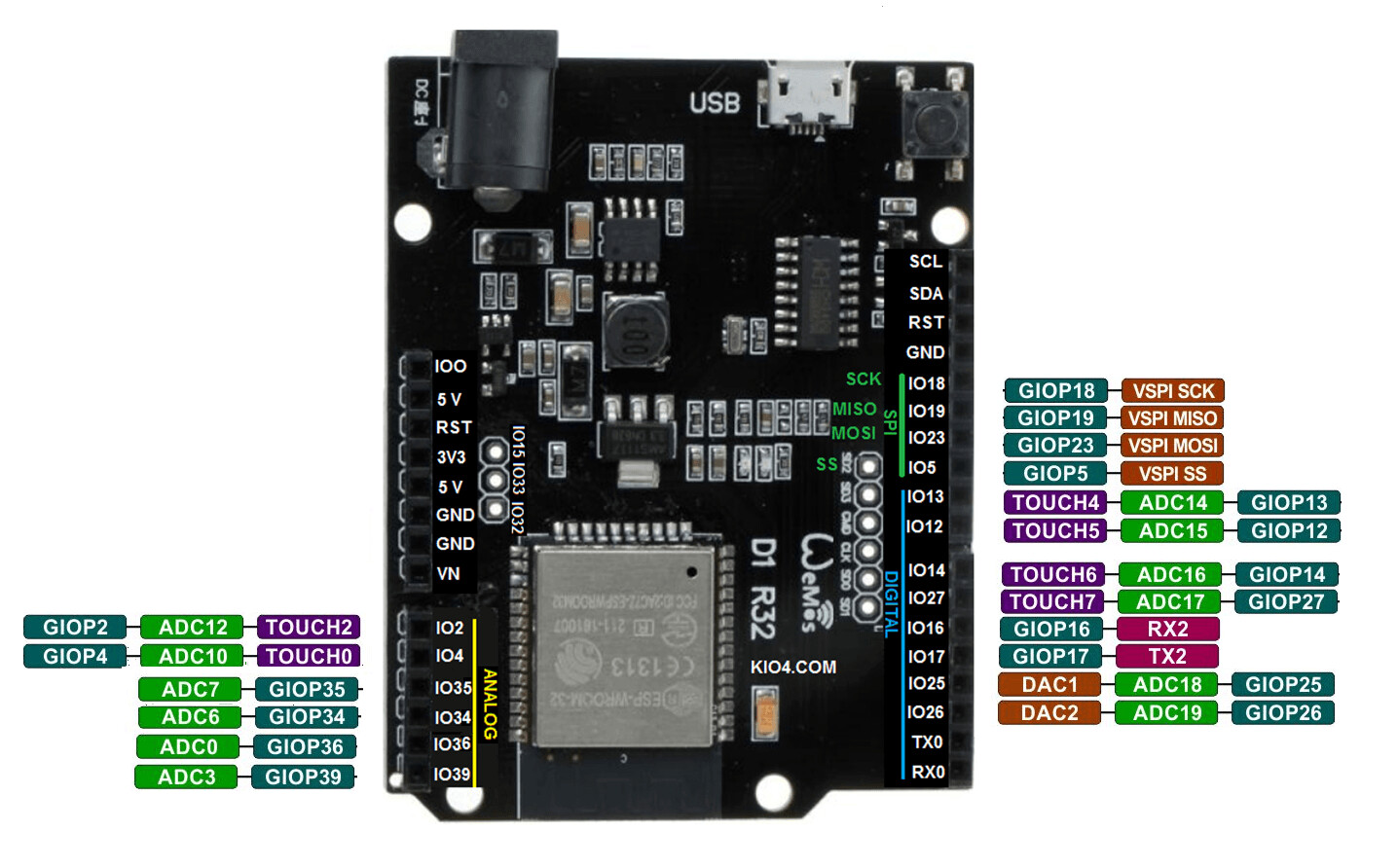

Well, solectroshop doesn’t seem to host the pinout, but with a search I found this: Wemos® D1 R32 w/ ESP32 UNO R3 pinout
The corresponding arduino pinout for comparison:
Here is the arduino pin assignment as routed on the shield:
Those taken together should show you how to work out mapping pins to assignments.
