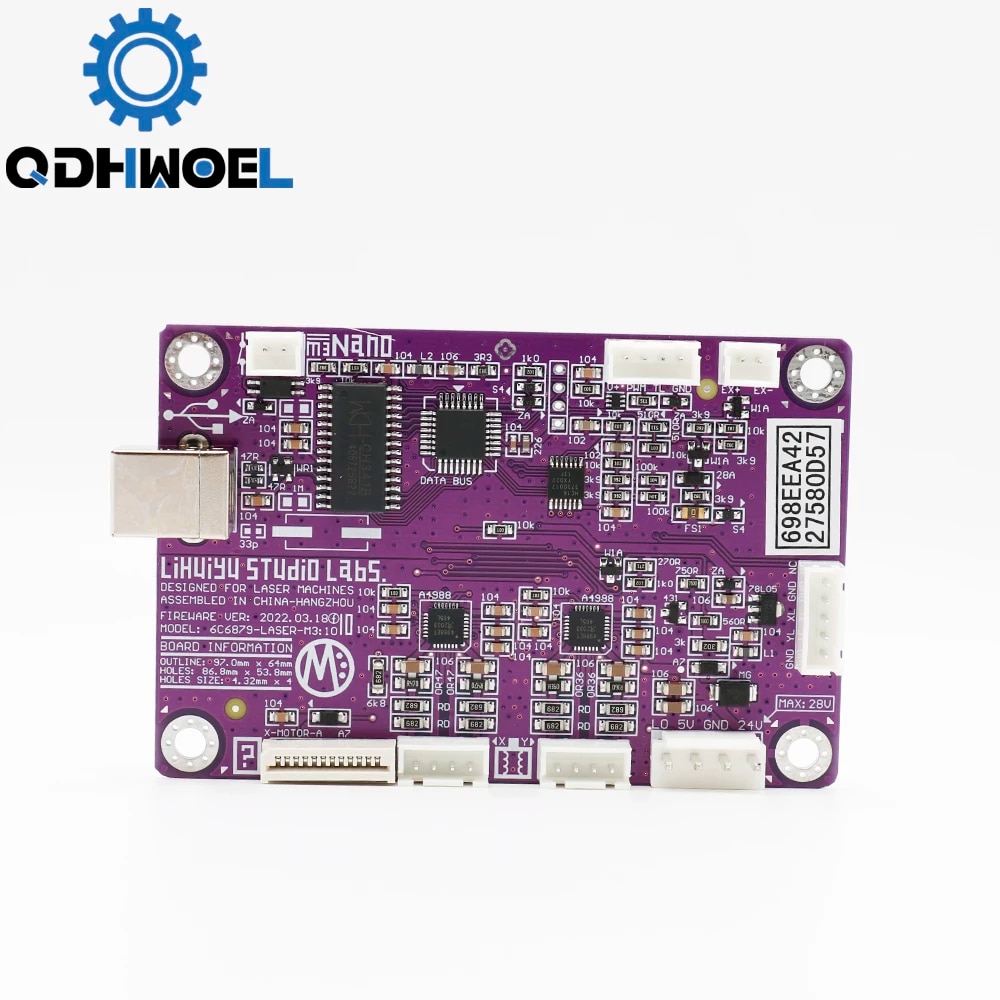

If anybody gets an M3 Nano (not M2 throw that away) don't trash the software
If anybody buys a laser and gets an M3 Nano purple board it has some yet undocumented PWM support, keep the software long enough to figure out the PWM control stuff. Most of the rest should be the same.
The GPIO added to the board (upper left-hand side) is likely just shorting SCL pin on the CH341B chip there and using the returned status as input. But, the PWM is likely hacked into the actual control codes so updating the Lhymicro-gl.
I author MeerK40t and to support the PWM, I’d need to know what it uses to control the PWM. Likely they added a quick control code with a value.

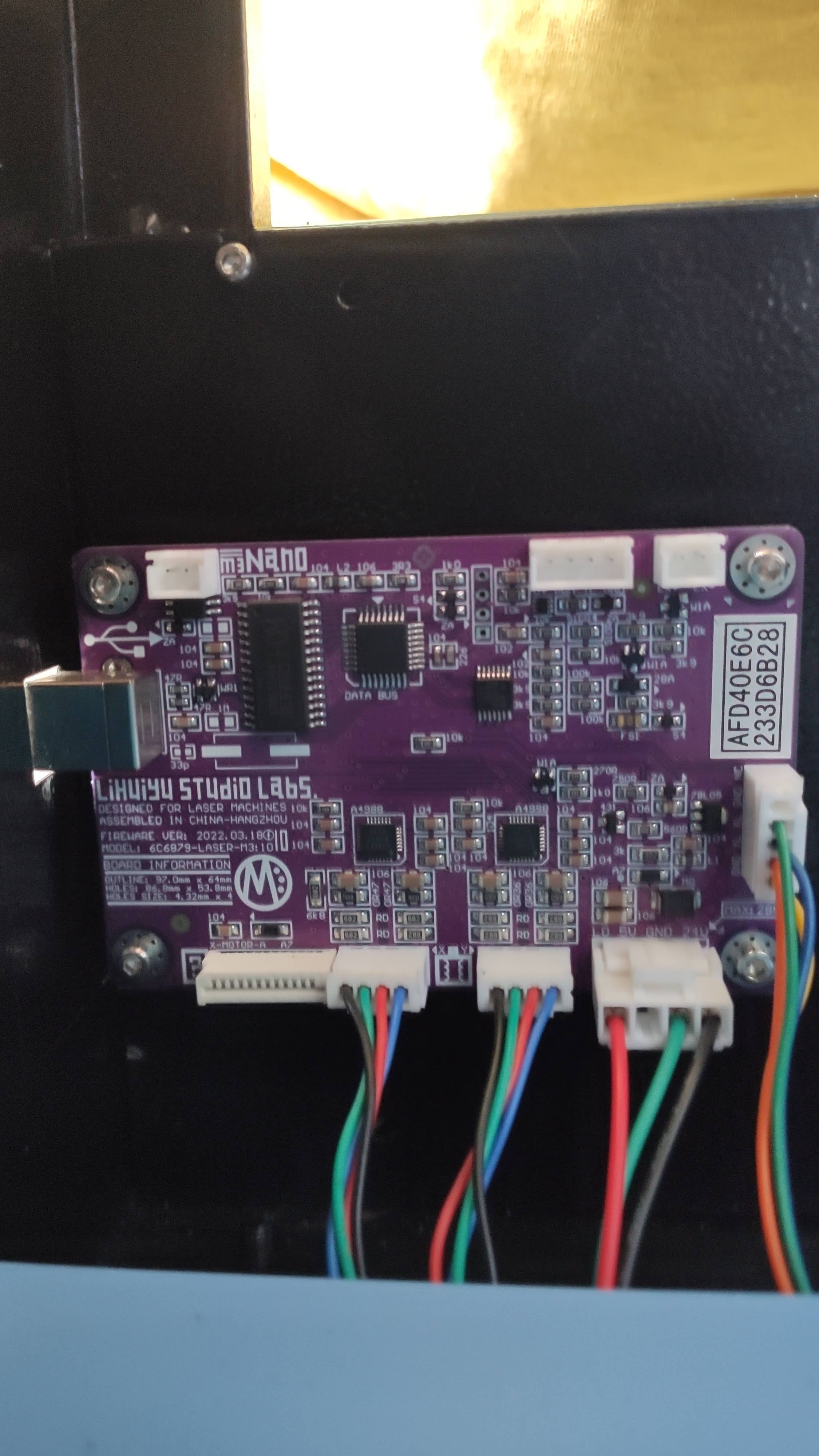

I am colorblind :sweat_smile: Is there a way to see if my board is purple? Some serial nr or by some port?
Did you get software with the board? I haven’t seen that any vendors have piped up with software here.
(FWIW I think it’s just that it says “m3 nano” — I think “purple” is additional to help people recognize, I don’t think there’s different variants of the m3 nano board.)

Here is the picture of the board and it is the same as o the picture above

You can always also check the version number the m3s are M3:V10s most of the M2s are V10. Also they have two extra plugs in the upper right and upper left of the board for the pause switch and PWM.
