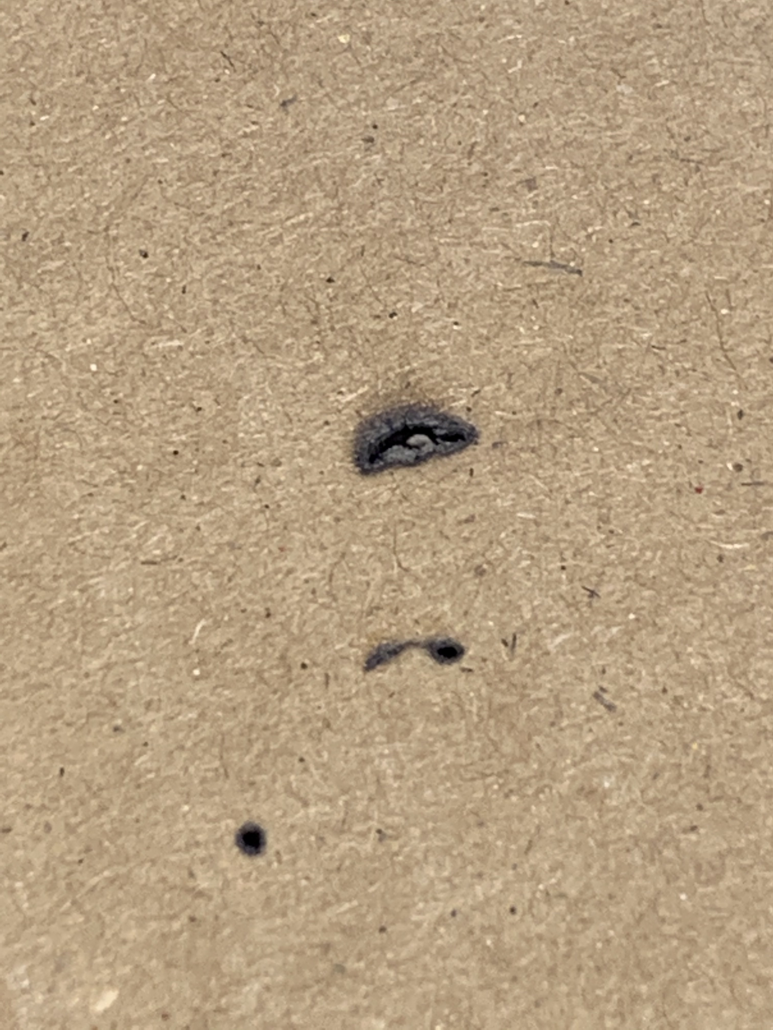

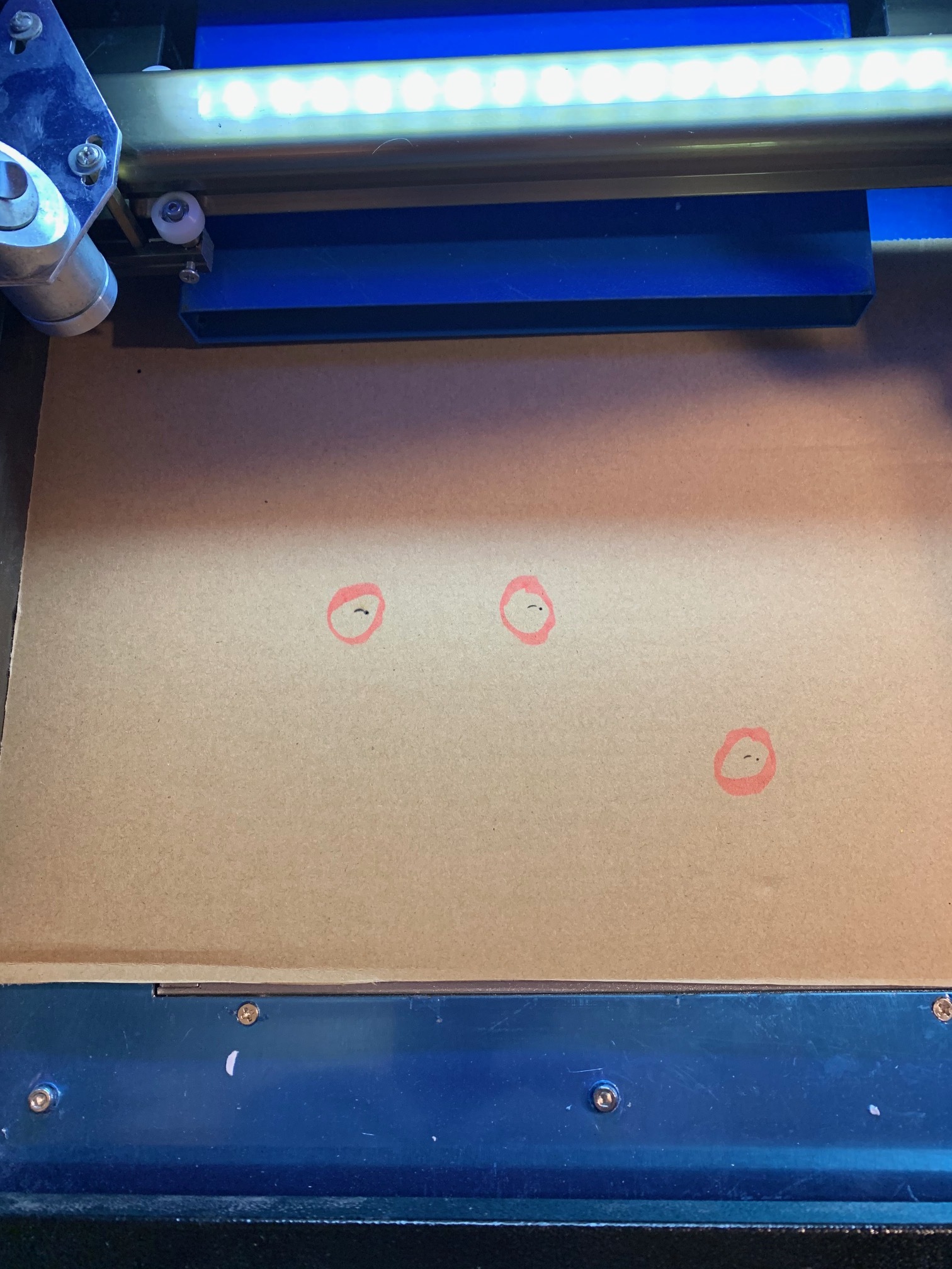

I got things sorted out and new distilled water in the reservoir and started the laser. Now the laser is burning a odd shape (see pictures)
I did clean the mirrors and the lens with no change. When I test fire the laser at the home position it seems fine. The other spots pictured have the problem.

@mcdanlj and others, I contacted the seller of my new laser and he asked me to check the light path and then see if the problem still existed. I did not do this because the problem was the odd burn pattern and the alignment seemed OK. I assumed the lens or mirror had a defect. But after I tweaked the alignment the problem went away. Before the burn looked like a sideways comma, it had a very separate and distinct “tail” off to the left of the primary burn site. Odd that this was due to alignment but glad it seems to be resolved.

Just FYI this was what I was getting before. Seems to be corrected, about to do a test engraving.
