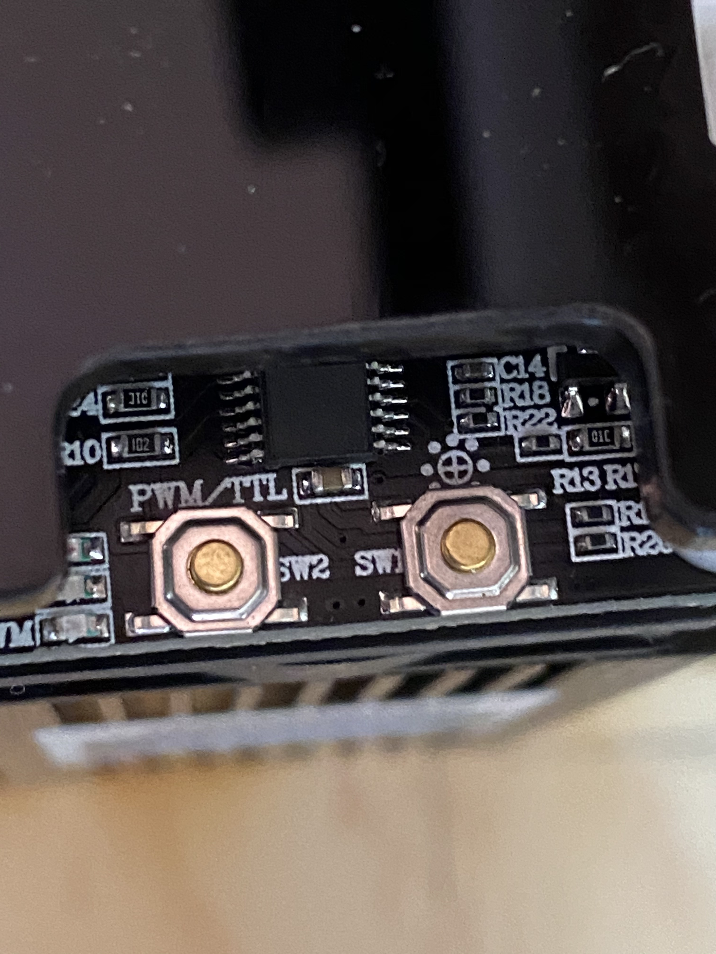

Hi , Alan here . I have bought a vigotec bx20 L7 . It says press button on top to start but there are two one has sw 1 and one has sw2 . Also one is marked PMW/TTL and the other has a picture looking like a gun sight
. I am new to this and 71 plus a Brit so any help with what you do with these buttons would help .

Can you provide more info and pictures of what buttons your are referring to?

i hope i have done this right .
Alan

Meanwhile, where does it say this? Some context for what you are reading may help figure this out.
I think those buttons are on the head?

Yes the buttons are on the head I I just found out the sw1 is for weak light and the other is full power . I will look on utube again . Thanks pi for your input anyway . Stay safe .

Hi Alan you had any luck with the sw2 button? I press it and the laser stays on and if you burn for example the transformer logo it will leave track marks and not turn off between sections! And it runs grbl 1.1with the alternate firmware with it so i am going to try lightburn
Have you used $32=1 to enable laser mode?
