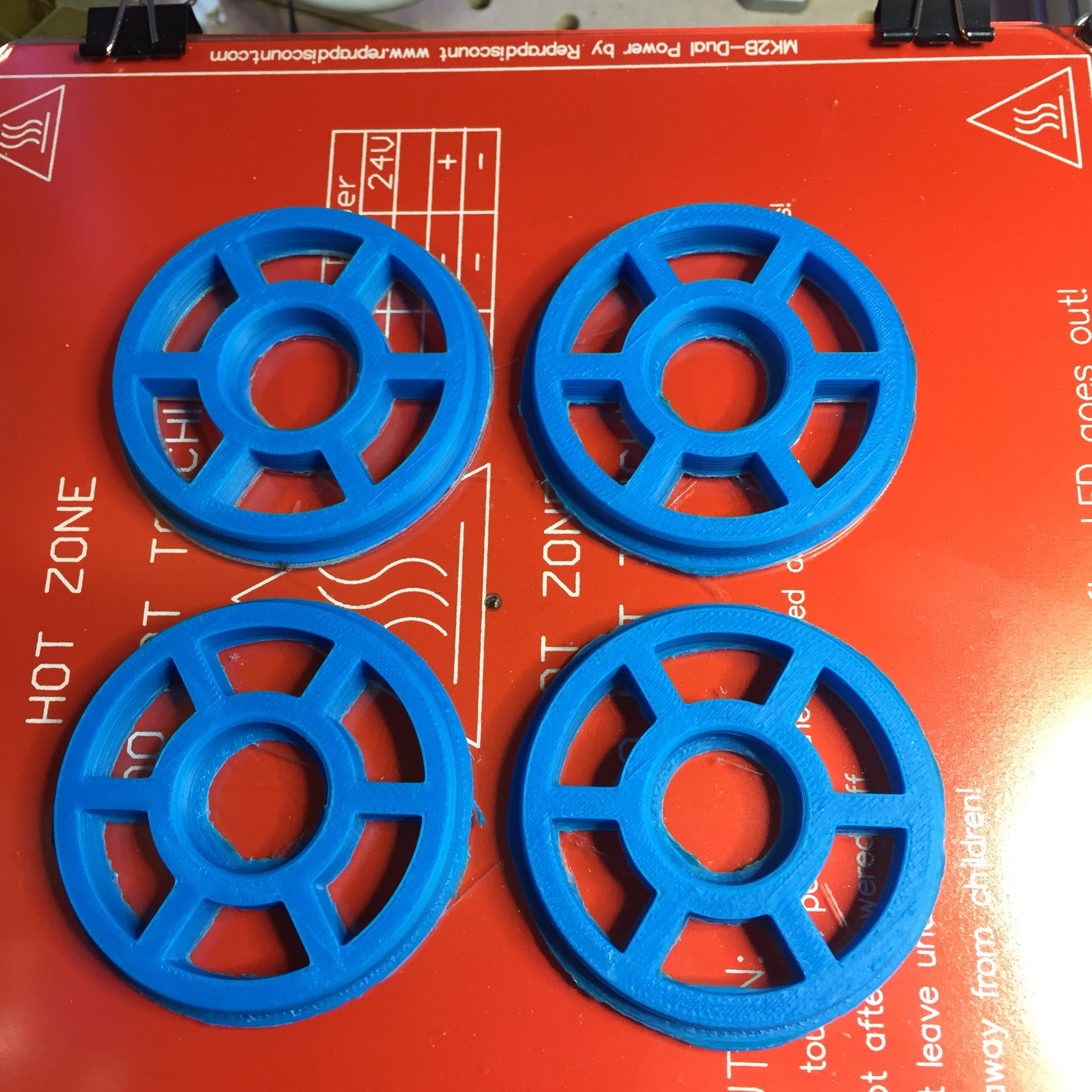

I'm now a believer in hair spray.
I’m now a believer in hair spray.
