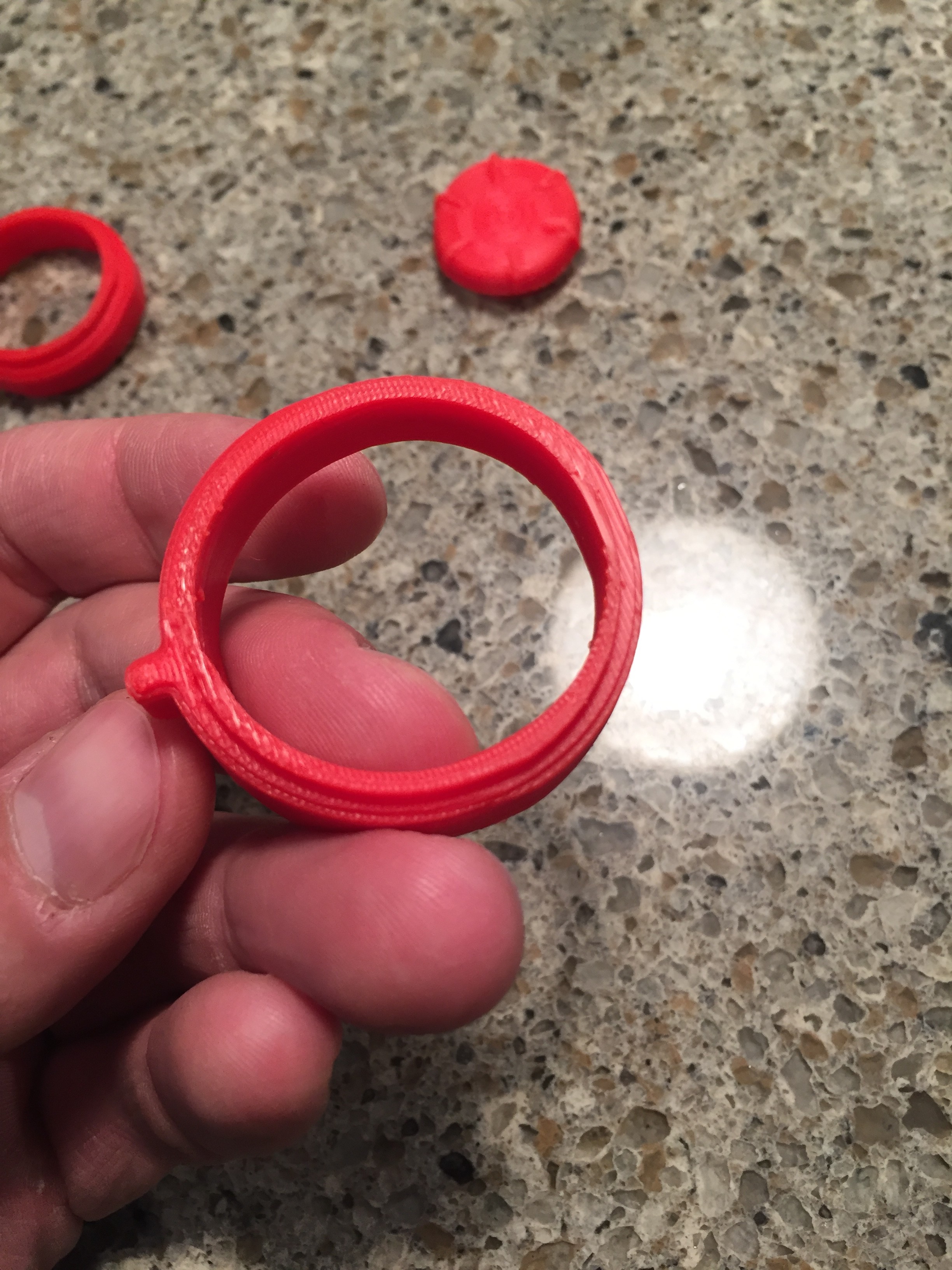

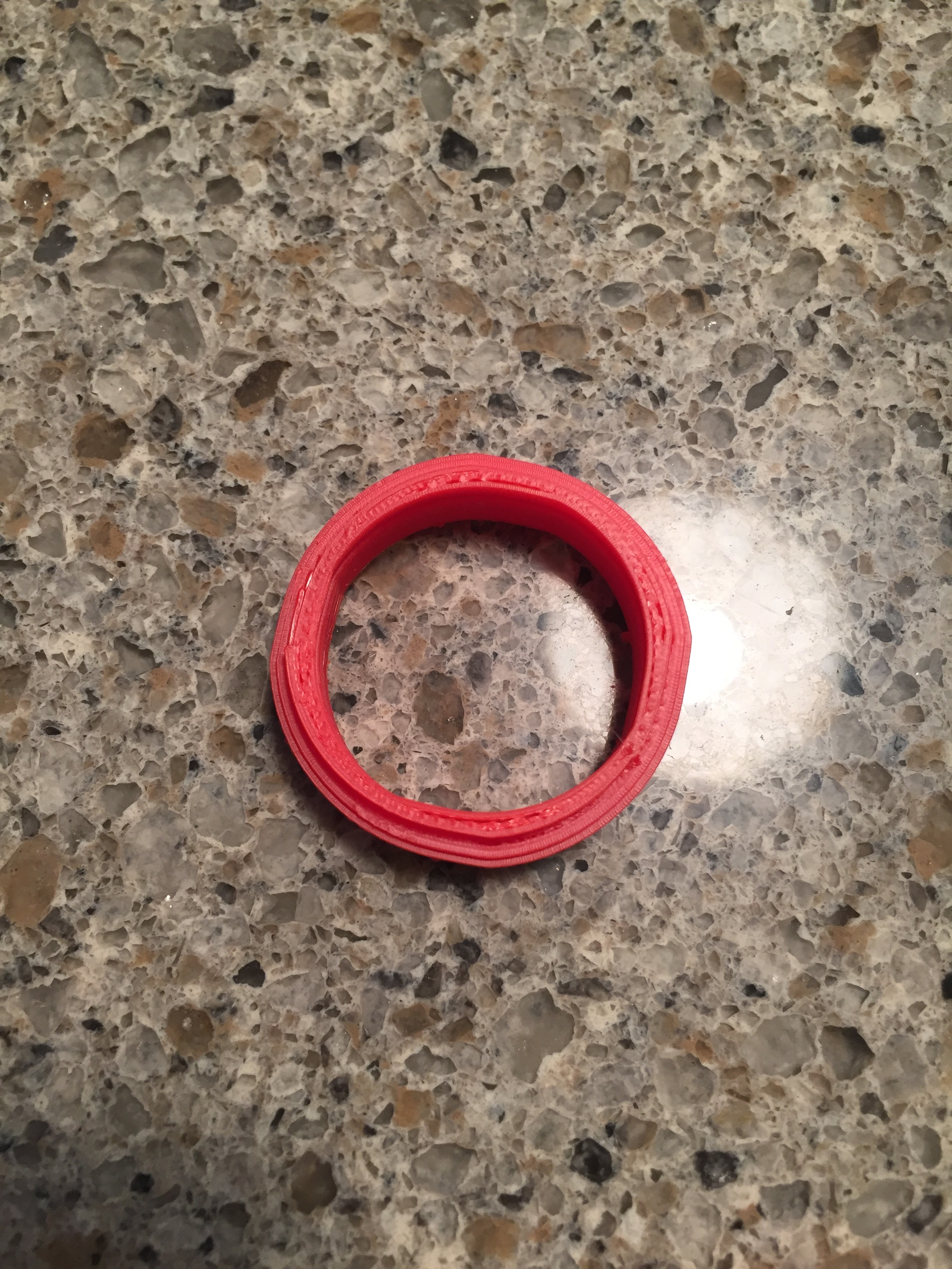

After messing around w/ all these various things I put the motor belts back on last night to give it another go, and the circular parts are drastically out of round now. Huge flats in the quadrant peaks of every round part.

Here’s a shot of the print issue that I was attempting to rectify. You’ll notice at the upper end of the part, there is some surface disturbance/anomalies on the face of the two semi cylindrical features.
Also more z-banding than I’d like, which I think is related to the same issue?
This may be belt tension, but I can play a musical (low G) note on them. I think they are a touch looser than prior to my tweaking but I think they are plenty tight. If it’s got a fault in its present config, I’d say it’s the positional stiction over belt tension.

But looking at your latest pictures above you’re definitely seeing either backlash due to lack of tension in the belts or sticking of the Gantry causing backlash when a direction changes on that axis.
