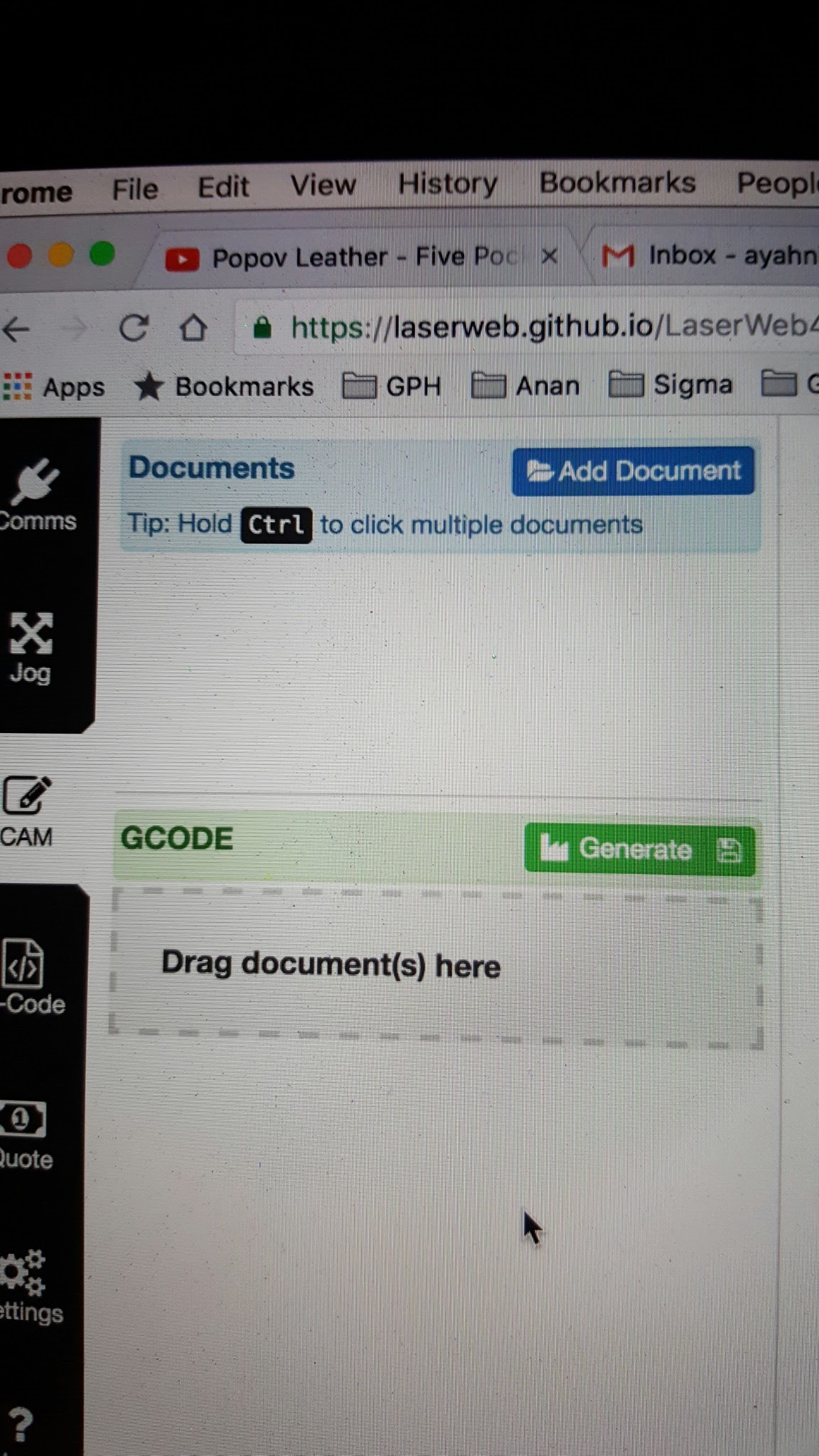

I’m trying to give LW4 a go, and I can import my document (BMP or SVG), but I’m not getting any settings for speed, power, etc. What am I overlooking?

You need to ‘add document’ then drag it into the section that says ‘drag documents here’. There is no visual cue that you are dragging anything (at least on my system), but it will appear and give you the options you are after.

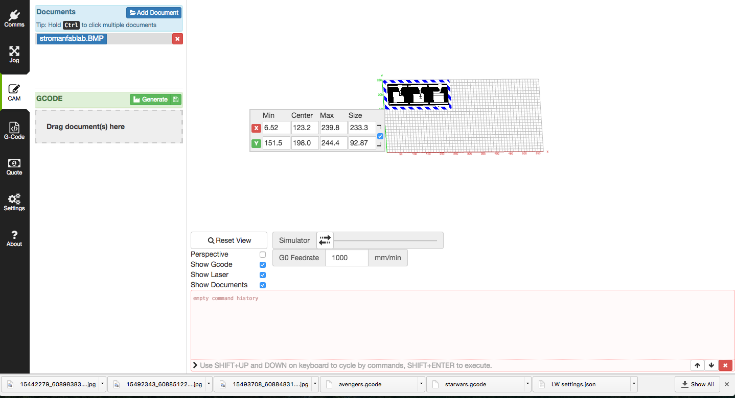

When I drag the document it opens the document in the window, but doesn’t actually show up in LW.

@K1111 seems you are dragging to hard. Yes at the moment there is no visual clue but is comming
@Domenic_Di_Giorgio , stupid question, but by drag, do you mean the highlighted name under documents?
@K1111 No. Drag as in click the name , move the cursor to the designated area and release

@Ariel_Yahni_UniKpty This may be an issue with my Mac. When I click and drag the name it ends up highlighting stuff and not really dragging the name.
@K1111 Yes, this was my problem. I needed to use a mouse for it to work.

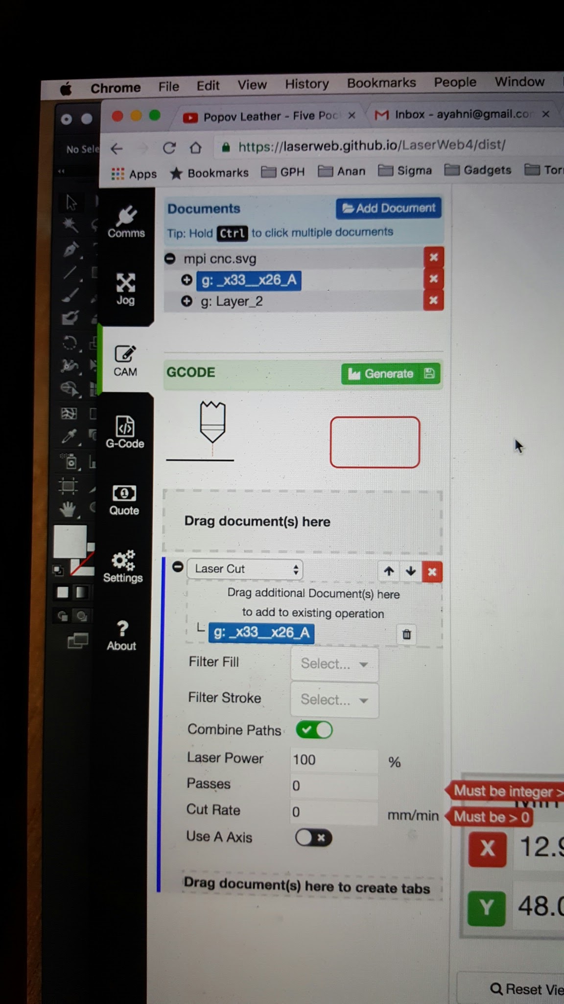

@K1111 im on a mac too. When you hover it will show a plus sing, the just click and move with releasing. It will highlight the current selection as multiple selection are possible. Note that on my mac there are several other issues

@Ariel_Yahni_UniKpty , here’s what happens when I try that with my trackpad (note the sort of shadowed lettering under the GCODE section.)
