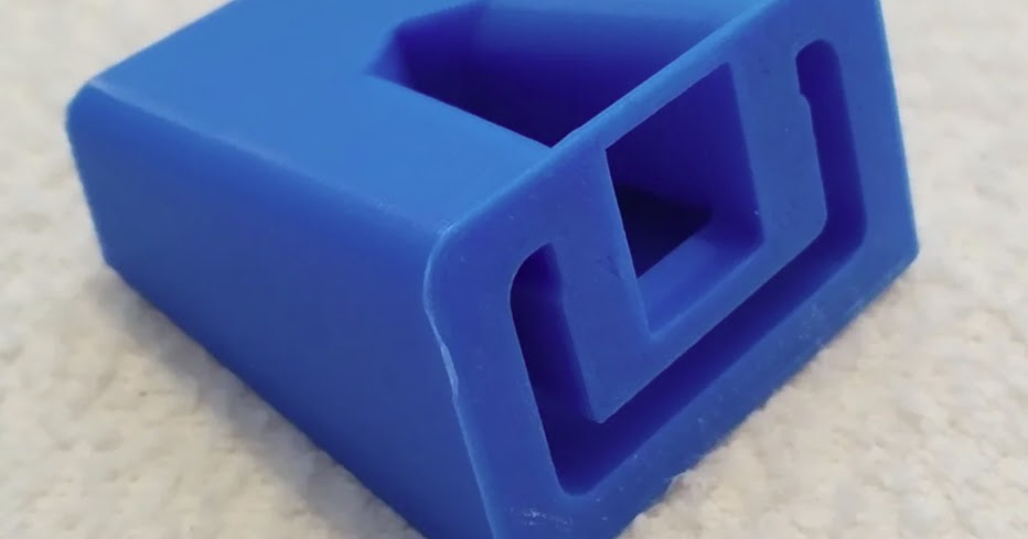

Improved design for 3D printing ear savers
Faster to print, less plastic used, thus lighter.
Starts with bias tape folders that similarly use less plastic, if you need that.
