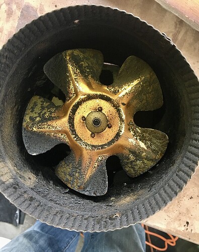

@NedMan here does beautiful work and uses an axial fan. Here he shared the results of cleaning out his fan:

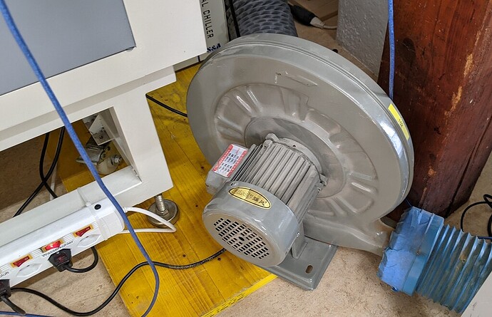

I ordered one with 150mm dia and 540m3/h. According to the specs its half the volume than we had with the previous solution. A bit more smoke is noticeable when engraving wood and cutting acrylic. But the noise is much lower than before: So a perfect solution for us.
