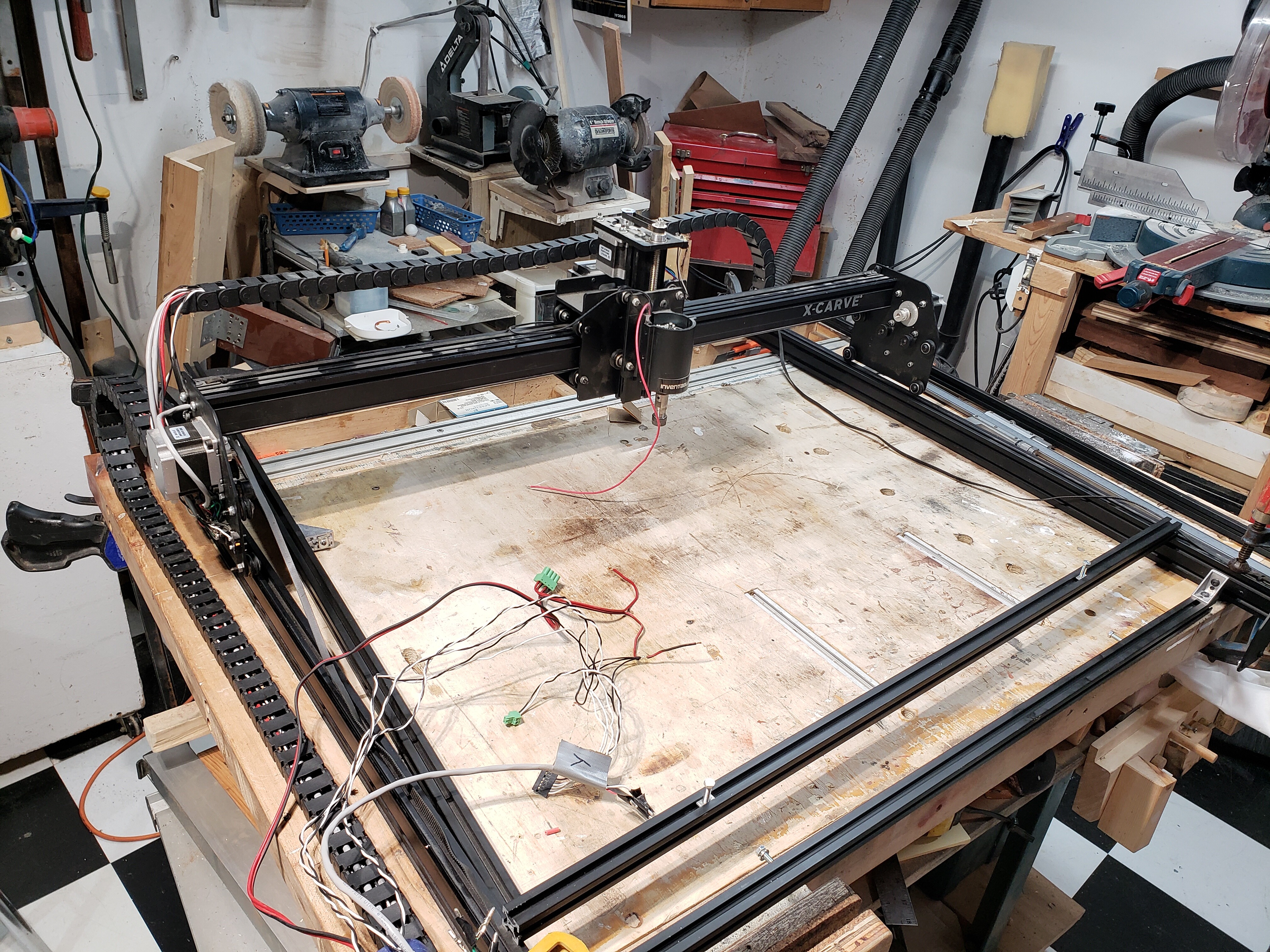

Hi michael, I’m just using the software that came with the machine. It’s not that great and the board is limited. I would like to install another board , but I really don’t have the knowledge on what to get.etc. When the unit stops in its tracks the laser stops too. Maybe the drive motor get hot but why I couldn’t guess. AND also to add to my problems , my son in law brought over a CNC machine ( x-Carve) which his brother had bought the kit but gave up finishing assembly a couple of years ago.
much of the parts are missing, like the controller board and some side panel plates. The motors are in place and wired to the frame. Is there a generic controller that I can get and use it to finish the machine, also x-carve seems to want to push their software called “easel” which needs to be rented from them. Is there some way I can run my own software with a affordable controller board ??? Not sure of the best way to approach this additional project as parts from x-carve can be expensive from what I have checked on their site. I am in canada and parts are in the U.S. so the added expense of 30% extra on exchange rate is also a killer.

For the x-carve, that’s doable too. But when you want to start working on that, please open a separate thread in CNC Routers and ask for help there, so that there aren’t two unrelated conversations in the same thread. It makes it easier to keep track of that way.
Okay thanks for the reply I’m going on vacation for a month out east so I may have to continue this problem when I get back but thanks for your efforts to this point. I will post my comments for my x-carve cnc as you mentioned on the CNC forum thanks for that. Will see you angels in about a month !!!
