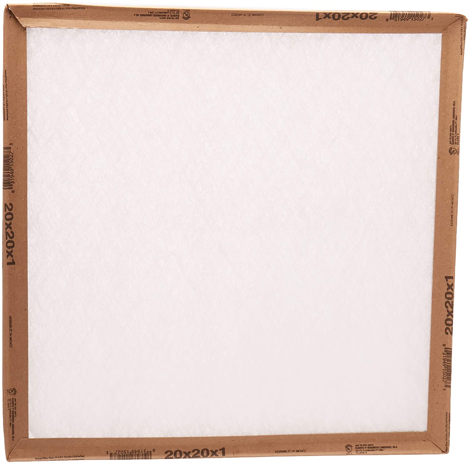

First stage, fiberglass MERV4 to remove the worst junk with least cost in $$ and least back pressure to airflow, $3 each, replace most often, e.g.:

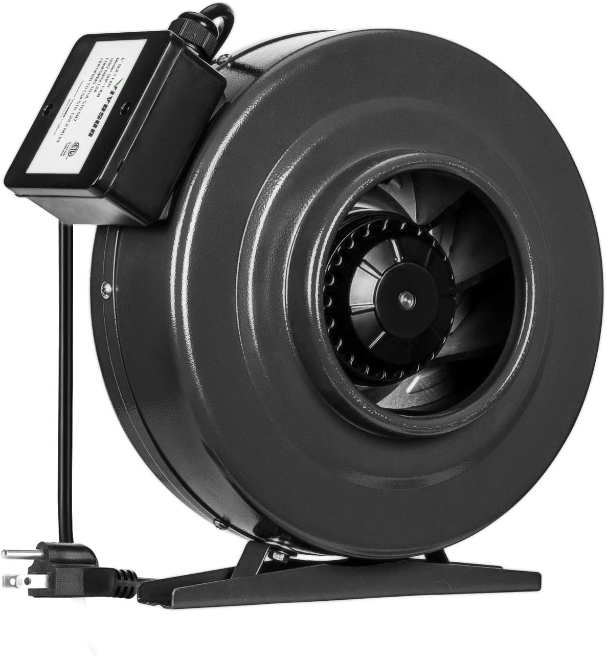

I just realized that another reason to consider this DIY fume handling is that the fan I bought is at least rated for twice the volume of the AD350. It’s a 440 CFM fan. Using this to pull fumes through those filters should clear up to one full air change every 3 seconds (ignoring impedance). If that doesn’t turn out to be enough, I could mount an 8" fan with 740CFM for $100 instead. (And yes @easytarget this also is aimed at :deciduous_tree: aficionados.)

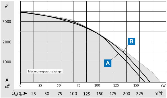

If you want the full picture, you need a pressure/throughput curve like this one:
NRG 137 performance curve (220 + 250 W)

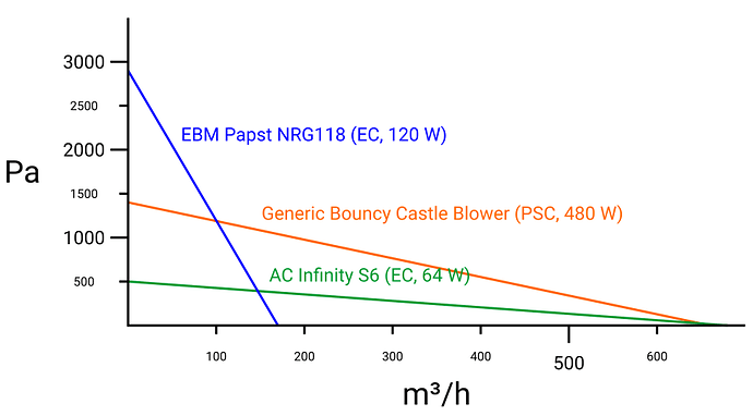

Here is a rough comparison between my old bouncy castle blower, my new Papst blower, and an AC Infinity S6 mixed-flow inline fan:
This is a bit simplified and only for illustration purposes. The actual curves are of course slightly bent upwards and not straight lines.
Anyhow, if the goal is to move at least 70 m³/h (which is what the stock fan of my K40 can move under ideal conditions), the quieter Papst blower would actually outperform the much beefier bouncy castle blower.
And there is another factor to consider: The pressure drop across filters drastically increases if you pull more air through them.
E.g. if the pressure drop across everything is 1000 Pa at 110 m³/h with the Papst blower, then the bouncy castle blower would not be able to move 200 m³/h as that graph suggests since the pressure drop would be significantly higher at that higher flow rate.
If you need more throughput, the best option are larger filters with more surface area. If you got twice the area, you can move twice as much air at a similar pressure level.
If you want to build a filtration unit for a specific existing machine, I recommend to measure the actual throughput (a sub $10 anemometer is fine for this) to figure out what kind of minimum and desired throughput you’re actually looking for. Then you’ll know which range of a pressure/throughput graph is relevant to you.

Yeah, that’s why I wrote “(ignoring impedance)”… I had no idea the rating of the blower in the AD350, thank you! I bought a radial fan instead of an axial fan because of the general understanding that axial fans have higher pressure at zero throughput.
