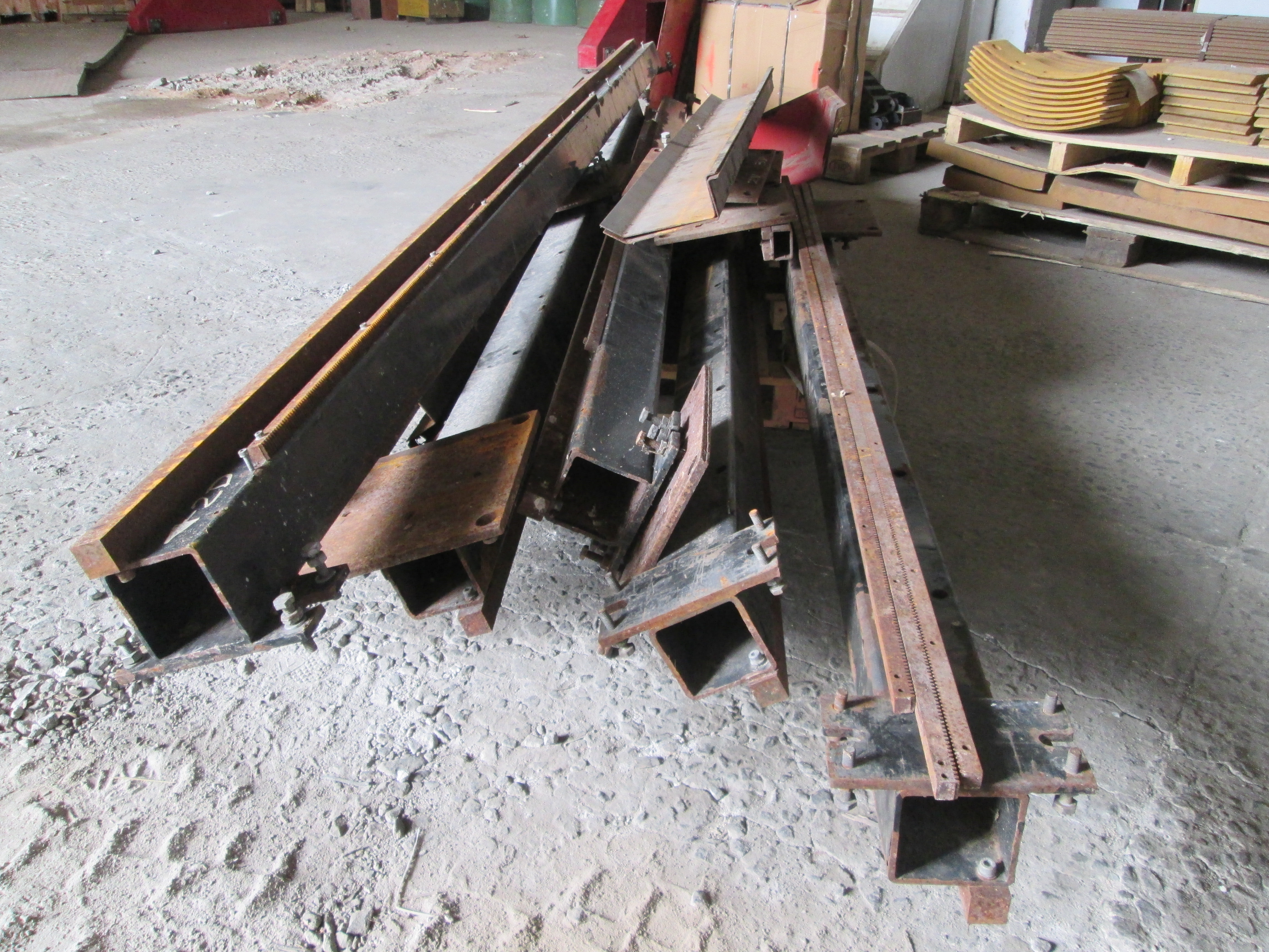

Yeah, will try to. The machine as it was when I bought it is like on the pictures over here
on this link: http://www.brastrak.com.br/files/cnc
But its state right now is not much different. We just repaint it now I need to find time and money to get the correct gearboxes, and of course most probably all the linear guides and racks. Probably will put on the helicoidal racks and pinions. Will keep posting here, but the story is still long.

Making it easier to see these files:
Wow! what a beast!
Dougl many thanks. In fact my initial idea was to use linuxcnc on a computermounted on the machine, but then I started to play with RPi and similar boards and then I tought it could be a worth to try. After all then I was thinking about cncjs interface. I am not very experienced , but I know my way on linux, although I have no much clue on how to connect all those servos and make the control panel. Still studying that part. I think its nothing very difficult to do but surely there is a lot of things to be careful on. I plan to use that machine for simple shape cuts we need to do for our products. Most probably will be more used as oxy fuel than plasma as we work with steels from 25mm up.
@mcdanlj thanks for doing it. This pics are really how the machine was when I got it.
