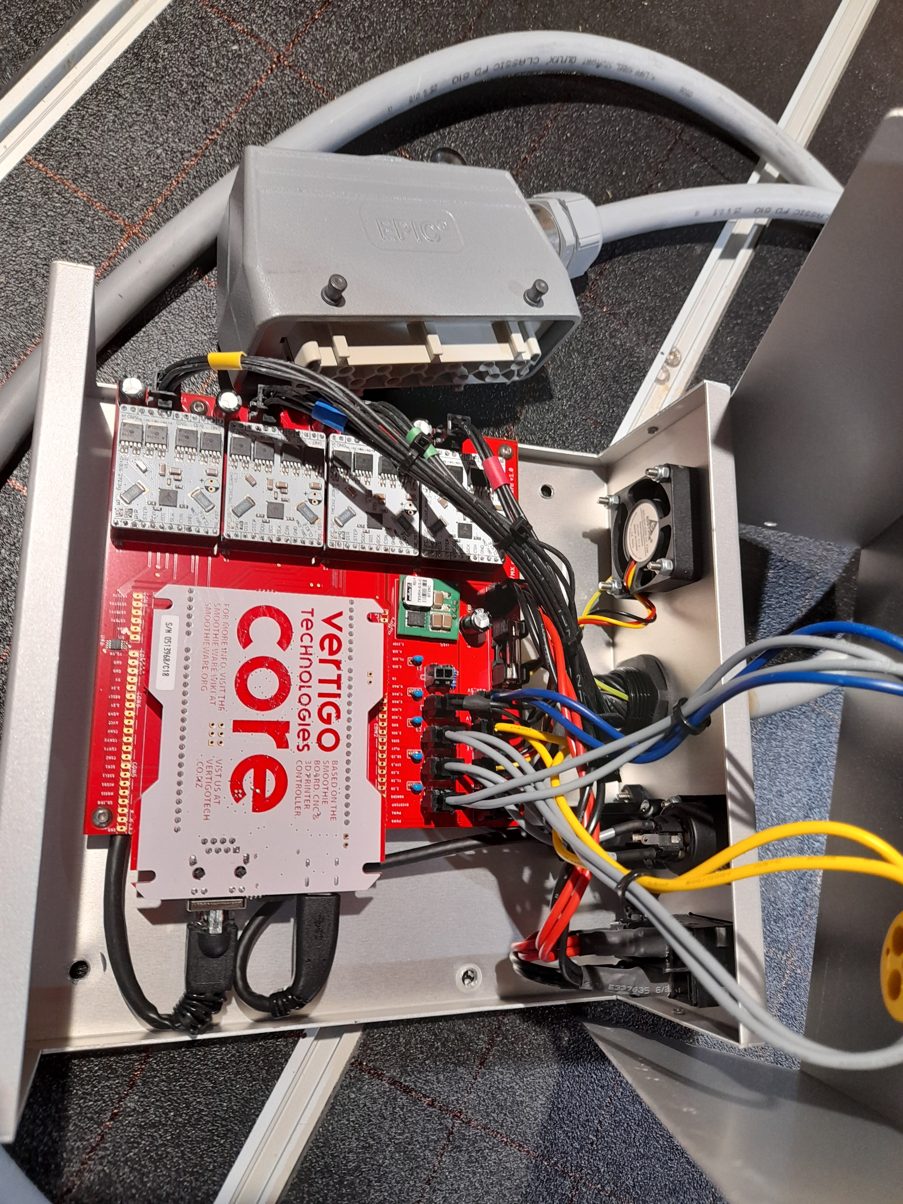

@DanNz2681 have you asked Vertigo for help first? It looks like they are running Smoothieware on their own hardware (since the official smoothieboards do not have USB-C), so they should be the the first point of contact for connectivity issues. There’s so much that can be hardware here…
What’s a vertigo CNC? (both http://www.vertigocnc.com/ and http://vertigotech.co.nz/ give me errors …)
What board are you using exactly ?
We can’t help you if we know nothing about the hardware you are running … you need to inform us to the best of your ability or this is going to be a lot more work/pain for us than it should be …

Hi
I’m not sure what info in particular.
See below attached
Apologies for the vague email earlier. I was at Mothers day.
Where did you get your firmware binary file, on the smoothieware.org website, or on the vertigo CNC website? Sent to me by Vertigo themselves
And if you got it on the vertigo website, can you please point to exactly where you got it.
And if you got the board pre-flashed with firmware, did they provide you with the associated source code? Nothing flashed yet.
