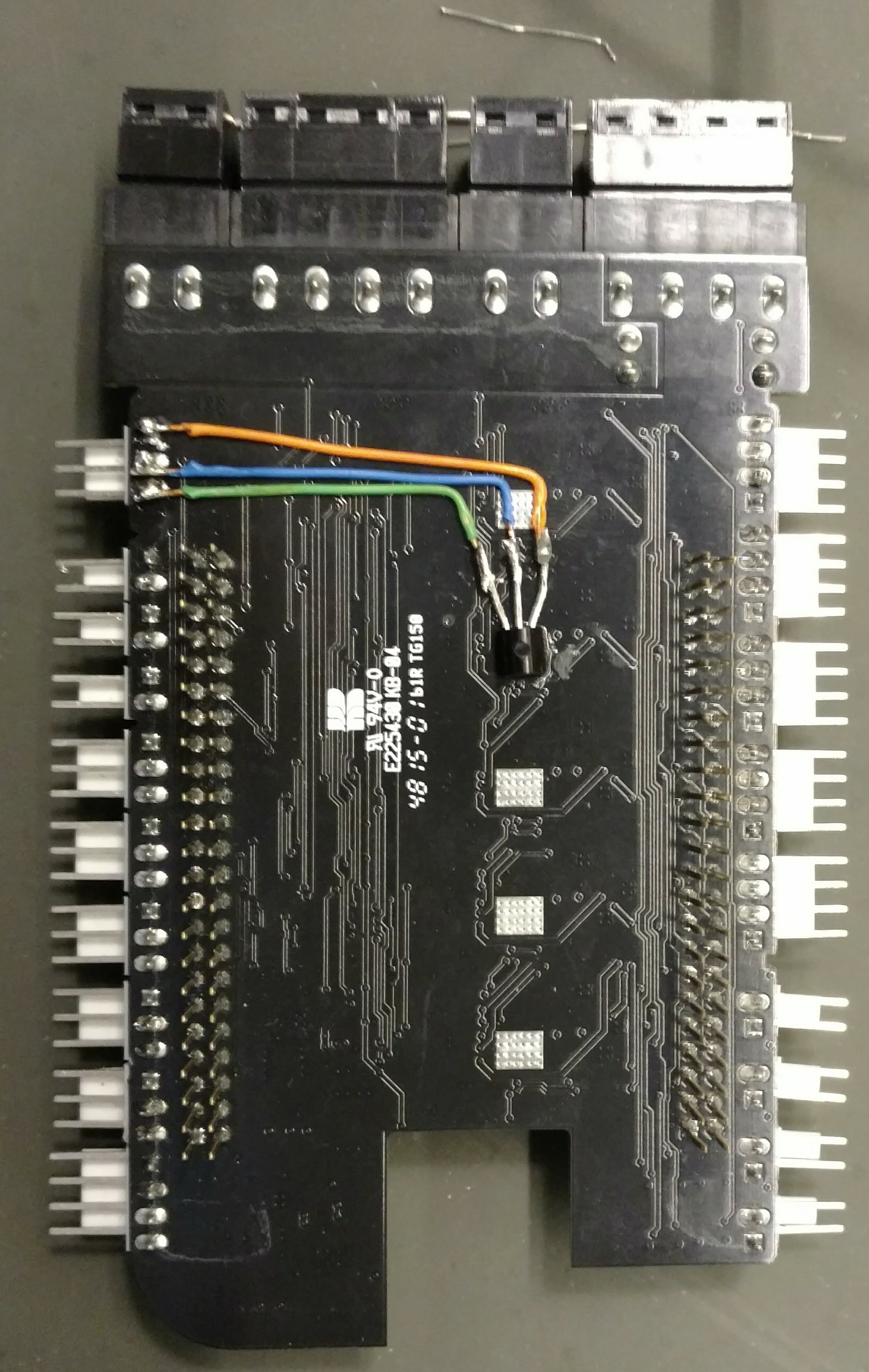

Not enough space to glue the sensors to heat sinks on drivers, I find. I think gluing just one sensor to the heat pad on the bottom of the board under the Y stepper driver makes sense.
Then I think I’ll solder it directly to the Dallas pins on the bottom of the board, rather than run it out to the header, to leave the header free to monitor the cold end temperature.
Ugly soldering job, but it’s not bridged.
