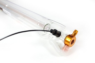

I am afraid that I learned all of this too late and now have a bad laser that was not cooled properly. Basically the water tubing pinched on the exit of the K40, stopping water flow and overheating the laser. So I have two questions:
  1. Is there a way to confirm that the laser is ‘bad’? It is barely cutting through cardstock at this point.
  2. If so, how easy is it to replace the laser tube? I found something online saying they’re around $200. Do you have a suggested supplier and instructions on how to change it out?
    Thanks all!
Hi Elizabeth,
There isn’t really a sure fire way to determine if a tube is bad other then a low power output (assuming a good mirror alignment). Sometimes the tube will shift lasing modes and you will get multiple or a distorted spot on the first mirror. If that happens then it’s definitely bad. If you have been running with improper cooling then it’s probably a safe bet to say the tube is now bad.
I replaced my tube with a SPT brand tube from LightObject that I have been very happy with. Looks like it’s currently $195 USD plus shipping.
They aren’t necessarily hard to replace other then the major hassle of of getting everything realigned. You would want to get some HV connectors because you will probably need to splice in at least the HV line (red). The link below is what I used.
Amazon.com
Hope this helps.
Ned

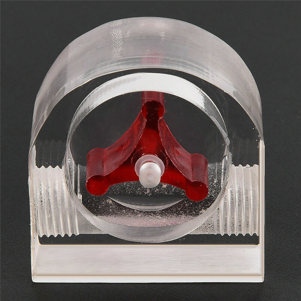

you might also consider a water flow indicator( and some have temperature sensor and display ) too.
example:

++ on the flow indicator. Better still, use an electrical one and interlock it so you can’t turn on the tube unless there’s flow and cool water.
Maybe someone makes an improved interlock upgrade kit to help with both personal and tube safety ?
You can get cheaper tubes than that from chinese suppliers. However they’re very fragile and easily damaged in the post. A local supplierm, even at a higher cost, is probably worthwhile.
A tube is a consumable. It’s sad that yours got consumed too quickly, but learning how to do it is very worthwhile. You will have to do it in the future if you use it much.
It might be thought that a electrical instead of visual fluid sensor is better but I’ve seen a tube ruined because the electrical interlock failed in the wrong position. The system thought everything was fine but infact the sensor failed and later the pump failed followed by the tube.
Getting used to hearing the exhaust fan, seeing the water flow and possibly earing the water cooler becomes normal operation and when one is missing it’s quickly noticed.
A firmware which controls water flow and senses the changing states would be the best option but until the firmware can do that, including a visual indicator with the flow sensor would be a good thing.
Yes, quite true. I have also seen a flow sensor stuck in the ‘flowing’ position.
That is the type of sensor where a bar is pushed by the water flow and held against gravity or a spring with no movement. When the flow stops, it falls.
The answer is to use one like that illustrated as a visual sensor - a little turbine. The wheel has a magnet on it and an external electrical sensor generates a pulse. The sensor circuit looks not for a fixed level, but for a train of pulses.
Just to clarify on the electrical work to be done to replace the tube, is it correct that one side has a HV connector and one side has a clamping screw? Will I need to order 2 of the HV connectors that you listed from amazon? I am assuming there are 2 HV wires? I need to get the order correct right from the start since my school is ordering the components hopefully. Thanks for all the info!
Only the end that connects to the laser power supply is high voltage. The end where the laser exits the tube is not.
According to the comments, it looks like @LightObject includes a HV splice in the kit now, so you shouldn’t need to buy another one. I’d suggest contacting them to be sure before placing the order. They have a chatbot on their page where you can ask, and they’ve always responded promptly to email questions for me.
LightObject did confirm that it comes with a quick connect for the HV connection. Thanks all!
