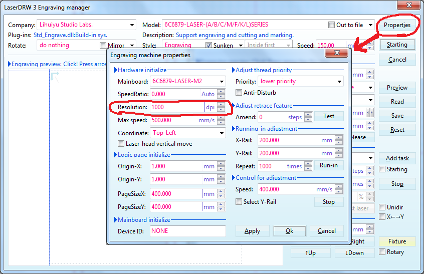

Short Answer:
From the LaserDRW engraving manager click on the “Properties” button the change the “Resolution” value.
Longer Explanation:
(This explanation is based on my understanding as of today. I may be wrong.)
Changing the “Resolution” does not change the number of motor steps to achieve a given move but it will change the smallest software step used internally by LaserDRW when generating the laser path. When LaserDRW makes a line (that is not vertical, horizontal or at exactly 45 degrees) the line is constructed of a whole bunch of small steps. Each step has a size equal to 1/Resolution. The default Resolution is 1000 dpi, so each step is 0.001 inches.
I have not played with the Resolution setting very much but I did set it to 2000 dpi one time and it seemed to work. I can only guess that the controller is using fractional stepping to achieve the small moves because the diameter of the timing pulley and the 200 step motors would indicate that the smallest motion from one motor step would be about .008 inches.
I am not sure exactly sure what you are trying to accomplish but the resolution is something you can change that may get you there. A higher resolution setting may create a traffic jam in the data being sent to the controller. The laser may start and stop while waiting for data.
