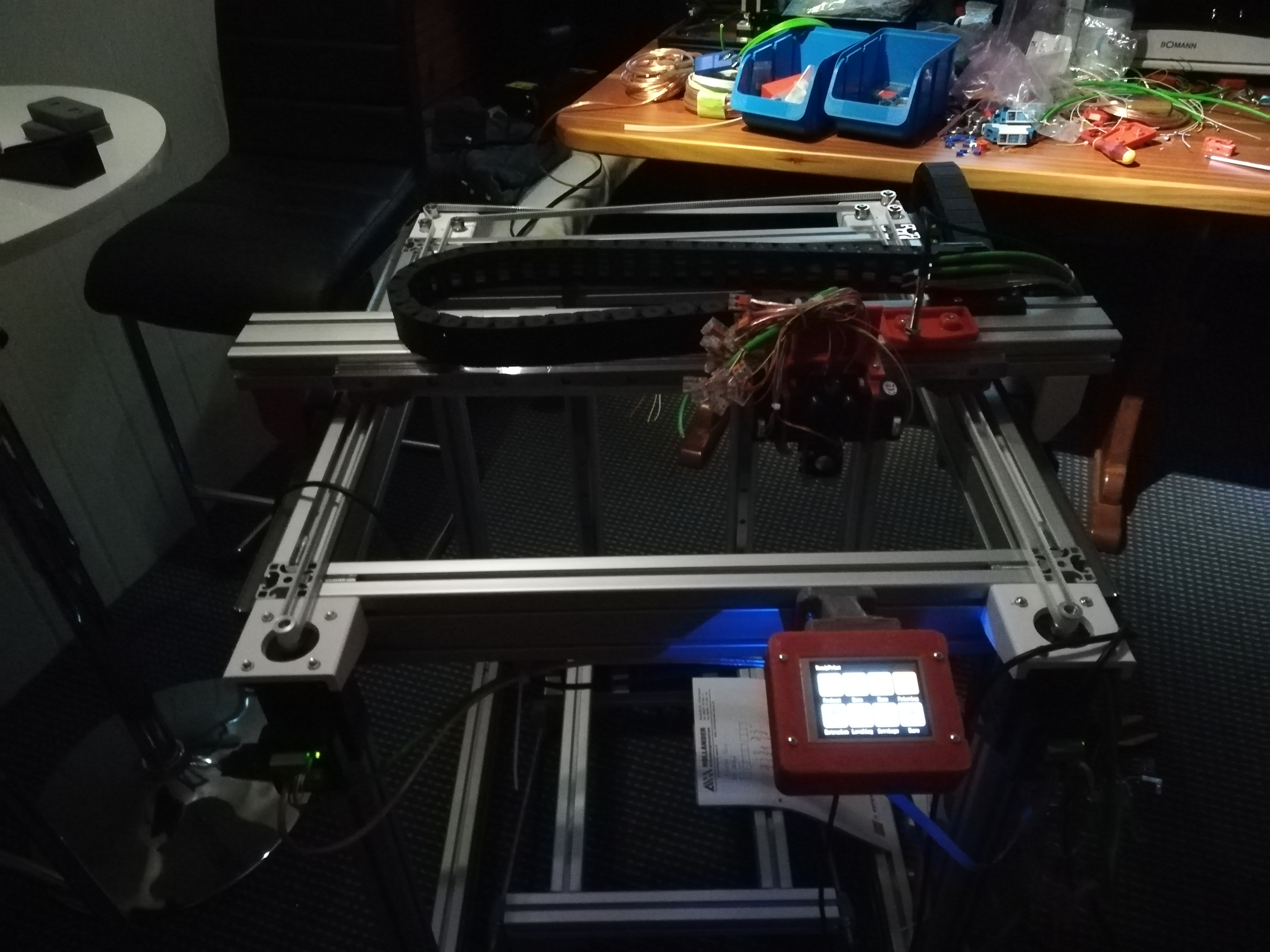

Hi guys,
now with pictures for you and technical details:
I attached you my config file, that you can see what i did, maybe there are some mistakes.

It is attached 2 Extruder motors at E0 and E1, to this 2 heatings for E0 and E1 and a thermistor aswell for E0 and E1. E1 has tourque and E0 not, but there i think it is a wiring problem. But it still didnt move.
Like you see, i have no reading of the thermistors, and the room has 20 degree celsius. I have there a other temperature measurment device. The XYZ motors are directly attached to the pins for the signals, all signals are used, and these are configured as open drain. On the + side of the signal there is +5V and on the mainboard i switch to ground. But there is no signal avialable.
Greetings Michael
