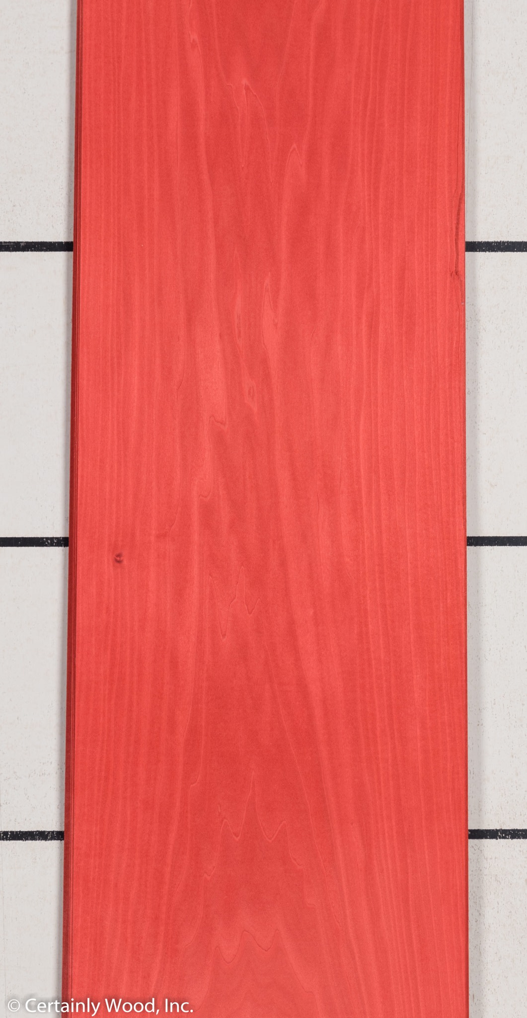

hey all, i was wondering was the best way to stain or dye a 3mm birch plywood, i try to stain my laser cuts with leather dye, and they look “odd” is a way to stain, dye, paint, etc, that make the plywood look a bit more exotic?
PD: this is a example picture, but is really close to how my plywood look after stain
