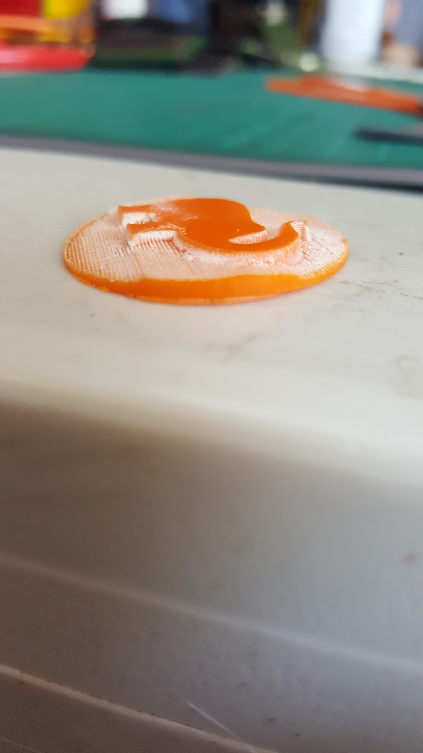

It seems the reaction time it not working here.
It seems the reaction time it not working here. Notice section without G0 is much deeper than section with both G1 and G0. What setting would help reduce this?
laser_module_minimum_power is supposed to help. I haven’t tried it.
Makes sense, I beleive I have it a 0

@Ariel_Yahni_UniKpty is that raster or fill paths?
@Todd_Fleming ​ that was raster on LW3. I’ll try LW later today
Hopefully fill paths will spend less time in g0. I’m curious to see how it compares.

I guess that has something to do with the lasertube and PSU, that needs some time to stabilize. What feeds did you use?
The S value for the lower regions was all the same, right?
10 mm/s
Hm, not so much. Could you post the Gcode file so I can analyse and try with my diode laser?
You could change the white color in the image to light gray, so these parts should also generate G1 instead of G0.

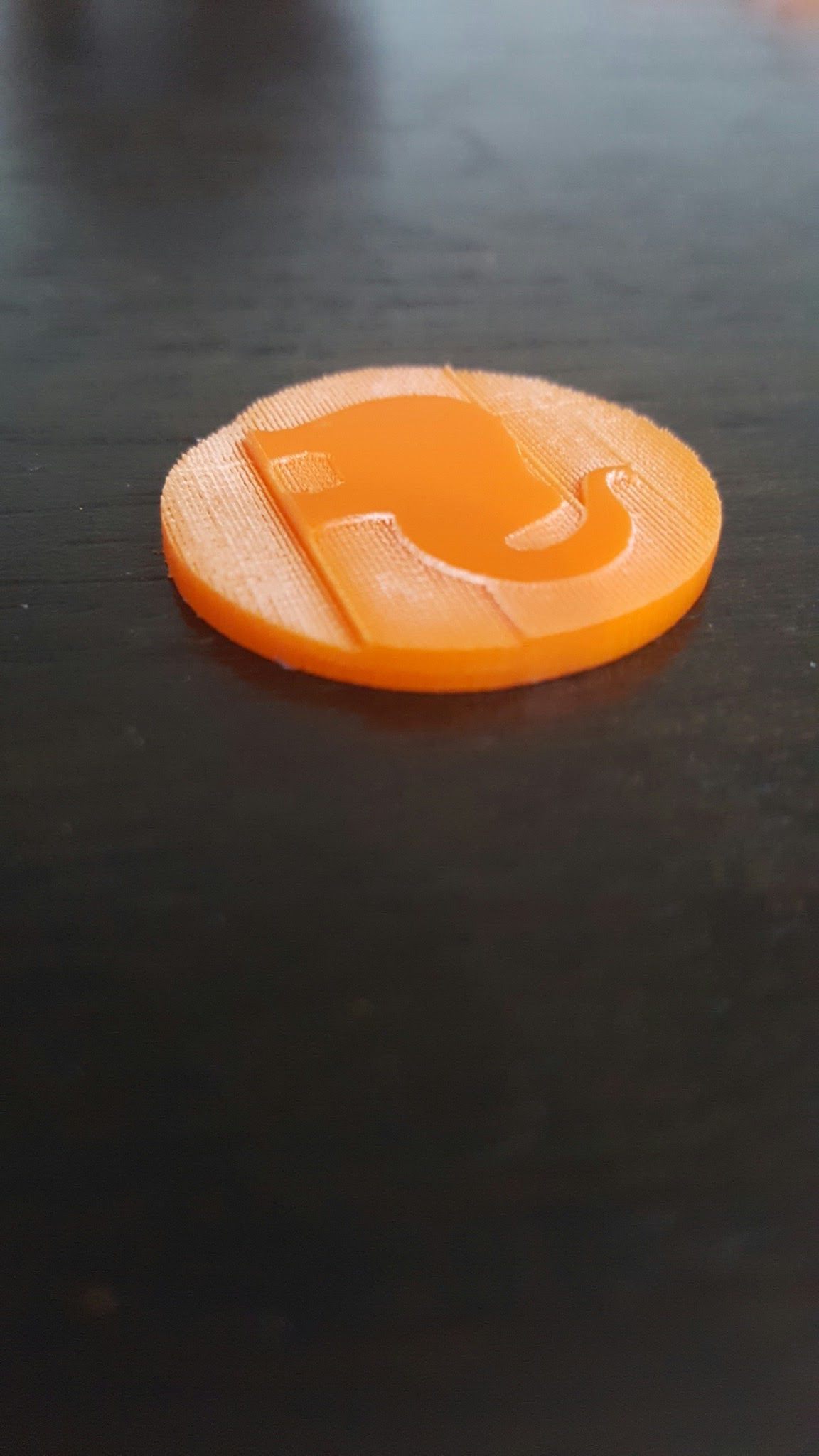

@Todd_Fleming ​ here is the Fill path version. As the line gets smaller then it seems as if the movement is faster thus the power is reduced. O so it seems
Dang. Its g0 moves are tiny, but that still causes trouble.

@Ariel_Yahni_UniKpty what material is that?
