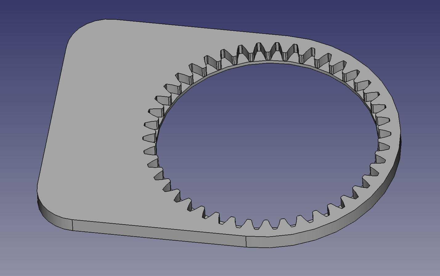

After Reverse engineering a 3d printing gear model I decided to start from scratch. I built a FreeCAD model that uses embedded parameters in gears to make it possible to print the sets of gears that you want, and I generated a set of gears that my wife (the mathematician for whom I did this work) asked for to teach a workshop.
I’m able to stuff all three rings and seven gears that my wife chose on my printer for a single print:
This is good because the print takes 3 hours and I’m going to be making six sets this weekend. :smiley:
The OBJ files are printable as provided. Choose slicer settings for high quality; artifacts from roughness on the teeth will make the set work poorly and/or be visible in the drawings.
To use, flip the rings over, so that the flange is above the teeth. The flange helps hold the teeth of the gears down so they don’t jump out.
The gears are used as printed. The upper tips of the gears are chamfered to keep them from catching on the flange.
The racetrack on the ring is to assist gripping the ring solidly to hold it in place during use.
If you want to make other size rings and gears, the FCStd files were created with FreeCAD 0.20.1 and the FCGear workbench. You will need the FCGear Workbench installed to make modifications.
In FreeCAD, select the gray InvoluteGear in the Gear, or the gray InternalInvoluteGear in the Ring, and then change the base property teeth to the number of teeth you want. (If you want a Gear with fewer than 15 teeth, you might need to edit the Drawing Holes Pocket sketch and delete (or change to construction geometry) some holes that collide.)
If you would like larger teeth (and, naturally the resulting size), change the base property module from 2mm to 3mm for both the Ring and the Gear and regenerate all the rings and gears you wish to use.
All the files, both the ten OBJ files and the two FCStd files, are available at GitLab:

I have pushed to gitlab an assembly that lets you look at a particular gear and ring configuration together to see whether it can function. You just load up all three FCStd files into a FreeCAD session, change the parameters, wait for FreeCAD to catch up with recomputing the gears, and then recompute the assembly. My youngest was curious as to what was the largest gear that could fit into a ring with 41 teeth, and we determined that it was a 36-tooth gear with the tooth shape parameters I chose; all larger gears intersected at least a little bit.
Standard shorter teeth could handle more, of course. If you want to have gears almost as large as the ring in a compatible set, you’ll want to change the tooth profiles for the gear and ring, which will require modifying the gear tooth bevel to match.

That doesn’t give you any ability to adjust parameters to change a design. A STEP file here wouldn’t be meaningfully different from the .obj files that I posted for printing. Just two different representations of a shape.

The point of using FreeCAD here — the reason that I included FreeCAD files in the package — would be to change model parameters to create additional models with different characteristics like which module, how many teeth, pressure angle, etc.
STEP files wouldn’t let you change those parameters. Yes, they can encode more than a simple mesh (e.g. materials), but they don’t allow you to recompute from parameters. Given that these parameters drive implementation-specific code, I don’t expect there to be any general interchange format that would transform a parameterized model from one CAD package to another.
