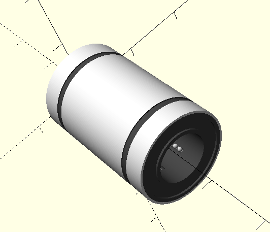

I’ve been fiddling with OpenSCAD for a couple of hours… it is really fun and powerful. This is a LM8UU linear bearing that I’ve replicated using the specs found on a popular aliexpress listing.
Is there a common parts library where the code for this bearing may be shared?

Thanks for the suggestions! @Fred_U ​ I am trying to model a simple h-bot out of standard parts from China and a couple of 3d printed supports, so I picked up openscad.
I see the value of having a collection of commonly available and cheap parts: it would be a great jump start for this kind of projects. Perhaps autodesk 123 would better be suited to the task

To answer @Davide_Candiloro 's original question, here are some libs I found with a quick google search:
Probably the best resource for finding them (from OpenSCAD docs):
https://en.wikibooks.org/wiki/OpenSCAD_User_Manual/Libraries
Built into OpenSCAD:
Other:
http://www.bolts-library.org/en/index.html
The OpenSCAD project maintains a library named MCAD. You should consider contributing your parts there. You would probably need to make your design more generic i.e. fully parametric. LM8UU would just be one instance of the design.
