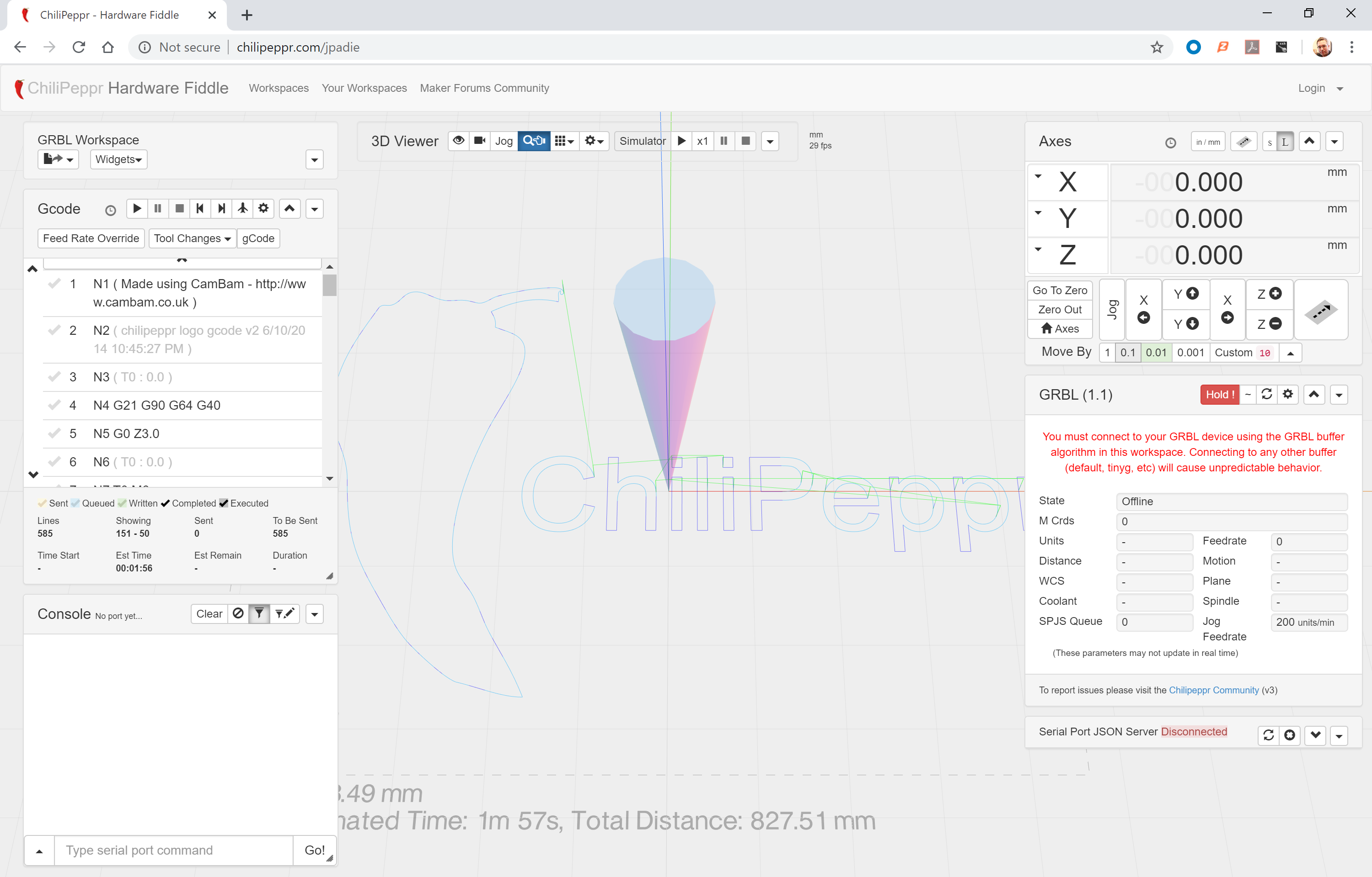

I find it has the ChiliPeppr demo logo work loaded?
If I send that off to the work space I get prompted with this,
And when I click on “mm”, the GUI work space shows the CP Logo underneath my PCB probing data.
And if I check in the GCode widget for the GCode, I find this
What I don’t get is how the Eagle Import widget can get the right PCB data in, as I can see it on the GUI preview, it get its size right, it can select sides of PCB, it Y-mirrors it, and the Auto Leveller can scan the right area, BUT it can’t seem to overwrite the new job and transfer the leveler corrections into the GCODE area.
In its present state if I asked it to run in the GCODE widget it would do the CP logo job (again) and not the PCB I was working on. There must be something fundamental I just don’t get.

I start out with the famous ChiliPeppr logo.
I load the most complicated sample board file.
Looks good.
So I generate the Gcode for the board. Looks good.
You see the Gcode now combined with the Eagle BRD rendering in the 3D viewer. It’s kind of hard to see the Gcode but you can see blue lines representing it now.
Then I turn off the Eagle BRD widget to get the board rendering gone and just keep the Gcode that was sent to the workspace. I think this is the most confusing step.
After turning off the widget you can see clean Gcode.
BTW, at this step I tend to just mill the board. I’ve found auto-levelling so frustrating through the years, I just keep re-milling over and over running the same Gcode to get the copper milled deeper and deeper on an iterative basis until all isolation has been achieved. Of course auto-levelling is the coolest way to do it, but it’s just so slow and I’ve broken so many bits due to the electrical signal failing during probing and I’ve been too lazy to upgrade to say a 12v probing system into my TinyG. 3.3v just doesn’t run through milling bits all that well.
Ok, now that I have my Gcode ready to mill notice the Z levels in it just for reference prior to auto-levelling.
Turn on Auto-Levelling widget.
You get your probe area auto calculated.
I’m just going to use empty probe data for this example.
I can view my auto-levelled gcode in a popup window. Sometimes I just cut/paste this to a notepad text file to store on my computer. I could even drag/drop that in later.
Now I’m going to send auto-levelled gcode to workspace.
Ok, the new gcode is there in the workspace. You can tell by looking in the Gcode widget and seeing how there are comments on each Gcode line that had a Z like line 7 that now says “N7 G0 Z1.0000 (al z mod 1)”. You should now turn off the auto-level widget to get it out of the 3d viewer.
Turning off auto-level widget.
Now you’re ready to mill.

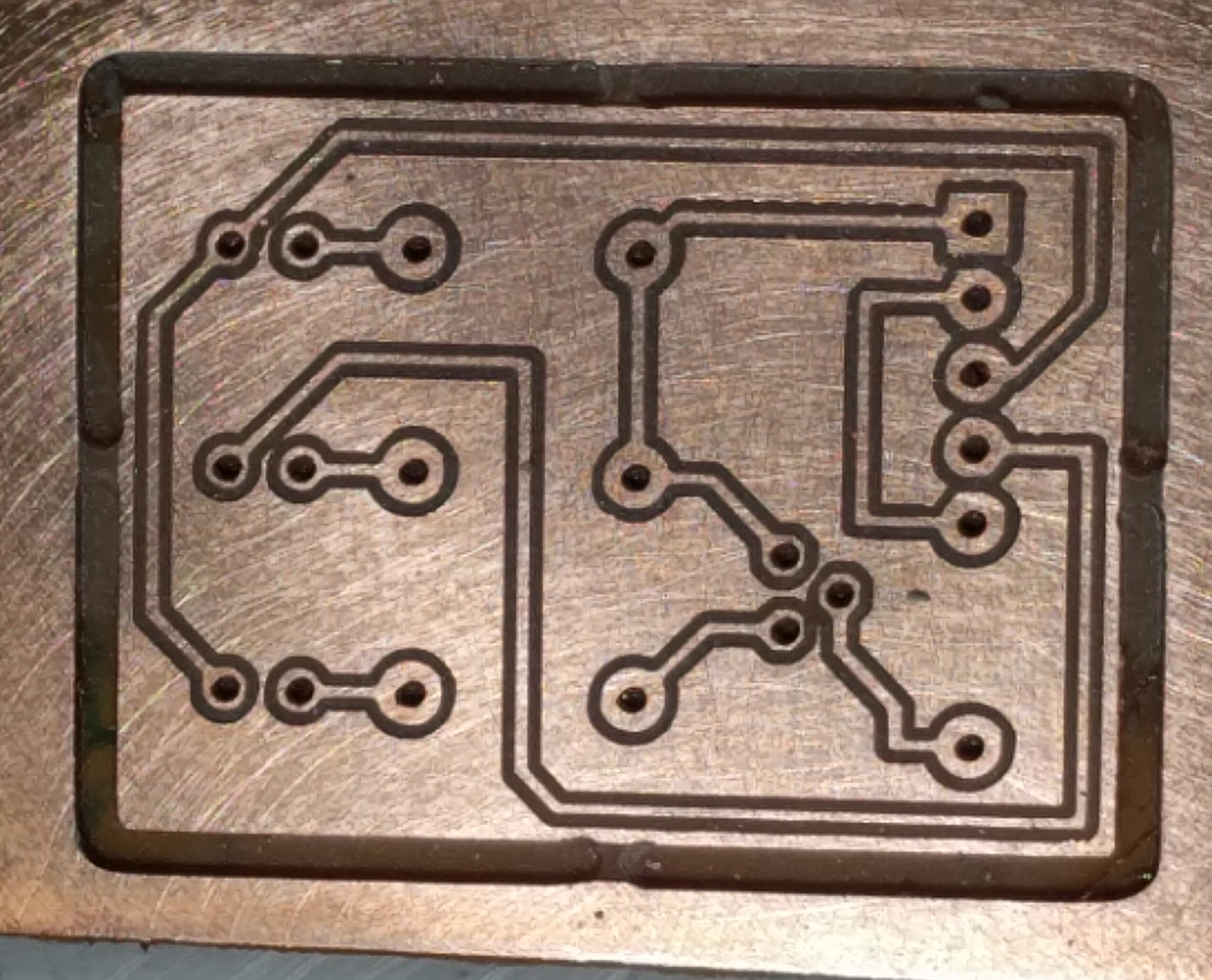

I am pleased to say I got a reasonably good PCB from the last run for tonight.
I turned off most of the Eagle Import options to drill holes and milling out the board to keep it as simple as possible. I have a little arrow stuck to my Z-Axis motor and it did not move while this was being cut, so somehow I have not got the Auto Leveling working just yet.
However from these results, I take your point about the Auto Levelling (especially for small boards like these) that it may not be worth the trouble. However I feel I cannot rest until I am able to use if I want to. It is like the Holy Grail of PCB Milling!!

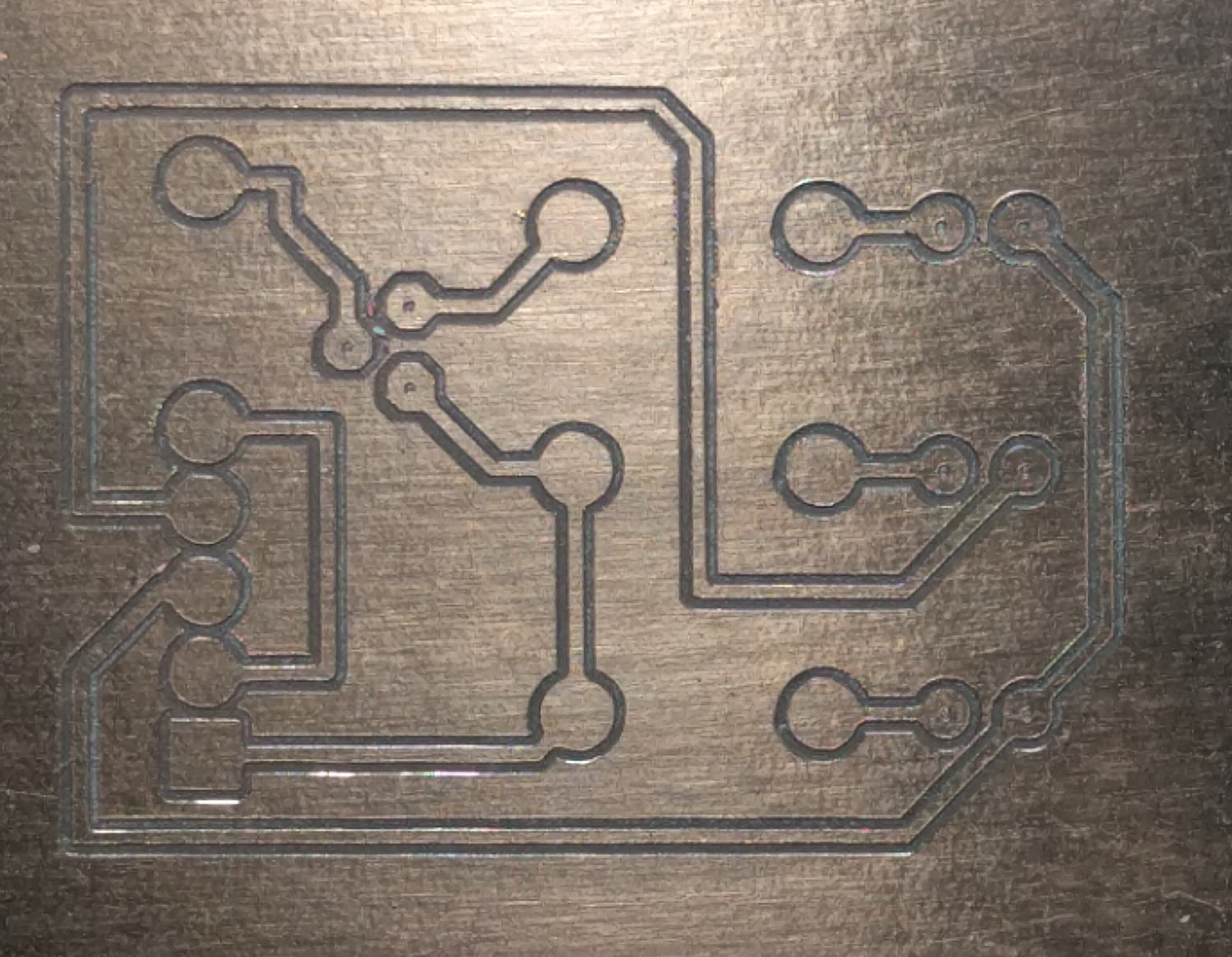

I feel I have finally got it, because I have finally a piece that I have used Eagle Import, Auto Leveling and Tool Changes successfully to make some thing useful. So from an engraving bit, to 0.9mm drill bit, to a 2mm Milling bit. It seems a long journey, but probably only more stressful because of the Corona Virus circulating around us at the moment.
I damaged my last engraving bit just before this run (10 more on order), but it still looks pretty good. I am documenting my journey as I go to be able to share with other Newbies (ie GRBL+Chilipeppr+Eagle). It is a tricky path, and not much room for human error, and certainly requires more intervention than 3-D Printing.
