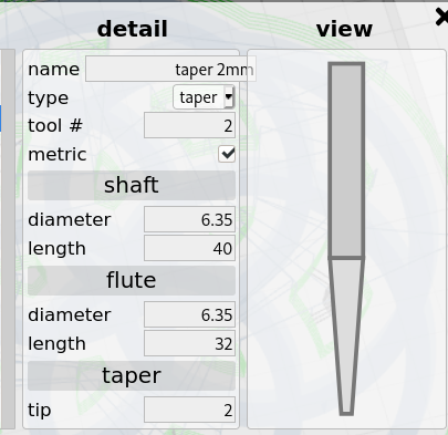

Today I discovered that kiri:moto has support for toolpathing with tapered mills. Since I just came up with an application for using tapered mills, my interest was piqued.
Oddly, it’s missing 3 of 5 identical pockets to clean out in this example.
I’m still deciding how to go about this one.
If it’s not too much trouble, I would like to see the settings you used for this.
Rough:
Outine:
My model doesn’t have the taper so I shouldn’t have told it that I was using a taper bit; I should have just told it I have a straight endmill and fudged the size to get the taper I want from that model. Or modified the model. But the weirdness was that it just didn’t follow two of the pockets, so I kept looking.
Are you saying these settings fixed your problem?
No. Those settings demonstrate the problem. I haven’t fixed it.
