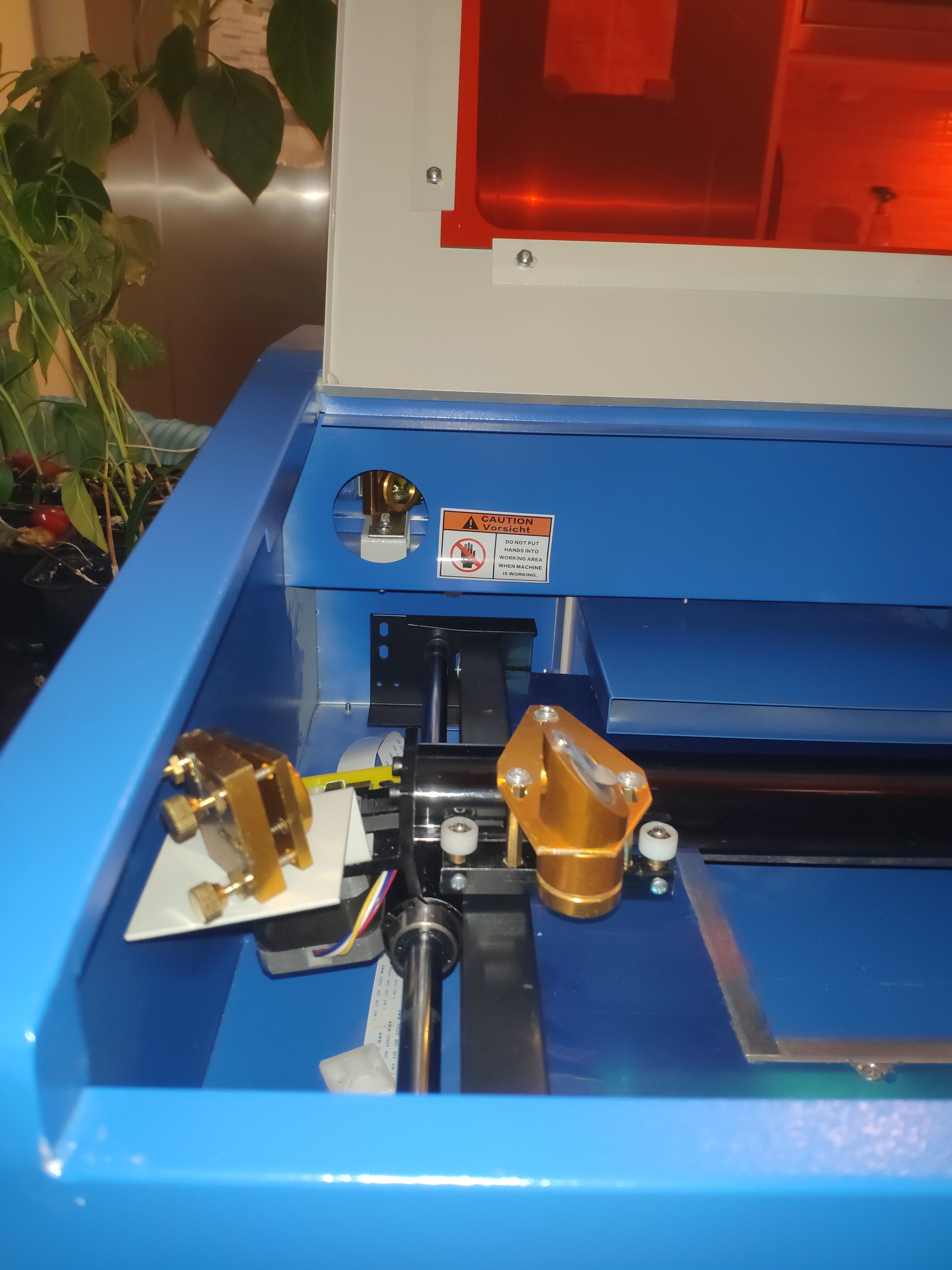

Hi,
Could someone please confirm my suspicions that my machine is busted?
The step-motor & mirror #2 are tilted at an angle making the belt drive lay flat on the mounting mechanics. It seems that the whole mechanical construction has shifted left.
Welcome to the forum. Looks like it got pretty banded up in shipping. You might be able to fix it but I would contact the seller about a replacement.

The bent aluminium T-profile seems pretty solid. I can’t imagine what have caused the damage?! The laser tube itself isn’t broken, as one might have suspected considering the level of force neccesary to bend the T-profile.
It’s like they’ve mounted a bent aluminium profile?!

I was looking for some damage to the lid since with the lid closed those parts are protected. If the lid is not damaged and still closes well then this was done before shipping IMO.
As for fixing it goes, the sheetmetal on the right side can be removed and straightened and so can the sheetmetal mirror 2 mount. The X axis motor mount is probably a goner since it’s probably Al and will crack when tried to bend back straight. If you are good with tools, you might find a piece of angle Al(or square tubing) and can make your own replacement in a pinch.
No, nothing else than what’s in the pictures is broken. The chassis/lid/laser-tube is all fine. I’m a bit puzzled; why would broken stuff be mounted…?
Unfortunately you will not know what else might not be working until you put it back into a working condition. There’s possibility of more damage that’s not visible to the eye.
Kinda looks like they dropped the assembled XY stage before putting it in the machine.
Are there any scratches on the top of mirror #2 or on the right corner of the gantry?
Either way, get your money back or get a replacement. I’d only try to fix it if they don’t want it back.
from what I see, those things were broken by a large force down onto the motor mount/mirror assembly. They were not bent and then assembled. You will notice the force of the left pulled the X axis ‘extrusion’ to the left and caused the bend in the sheet metal on the right which holds the roller.
It’s likely someone knew this was damaged and to keep unseen, just packaged it up. As mentioned, document the heck out of this and contact the seller. I would check the X axis extrusion for being straight/true also while you have it apart.
Don’t go there … lots of damage that you can see and even the tube could have damage you don’t.
Perhaps this was damaged in shipment and they put a new lid on it … looks like dust on the surfaces in the back of the machine, been in storage?

I’ve dismanteled the broken parts. I was surprised of the low quality of the machene! Even the metall in the screws are of low quality, it’s very easy to damage them just by unscrewing.
I managed to straigthen the aluminium profile w/o breaking it. There were other wiered stuff that I can’t even go into the details of.
When put together again the mechanics seems ok; end sensors are triggered and the belt drive looks and work fine. When switched on, the laser head goes to the start position.
