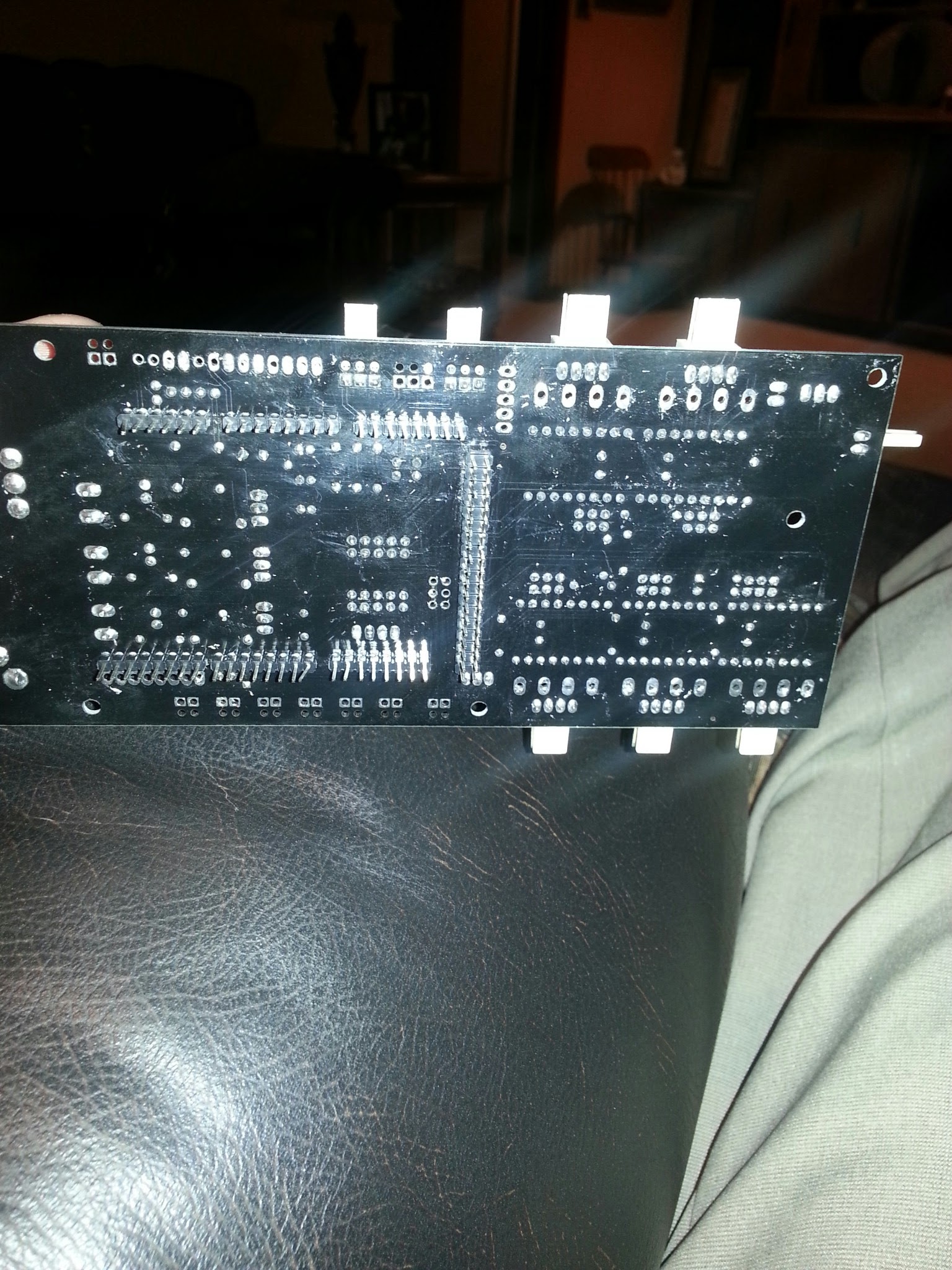

Just waited 2 weeks for a $55 sainsmart Ultimaker 1.5.7 board.
Just waited 2 weeks for a $55 sainsmart Ultimaker 1.5.7 board. And this is what I get? Worst solder job ever! They were suppose to have 3 thermistor hookups and is missing one. And not a one end stop connector. Super dissatisfied!

sloppy work… to much sake with lunch?
how does that make it out of the door?

Those pins are a bit much. Guess noone had any flush cutters…
looks like they just applied molten solder to cold connections
@Patrick_McMicken or a desoldering pump or depth perception or another thermistor connector. there is even a solder pad where nothing is soldered that looks burned off. bent header pins. and was in a box heavily wrapped in bubble wrap. so it happened in the factory. there even a few blobs stuck on the side of resistors that are standing upright.
I’m going to see what they do about this. Take hours to fix it all by hand

Some ebay sellers grab the QC failed boards from where they work and sell them. Maybe that’s what happened here. Or, are all Sainsmart boards crap?
