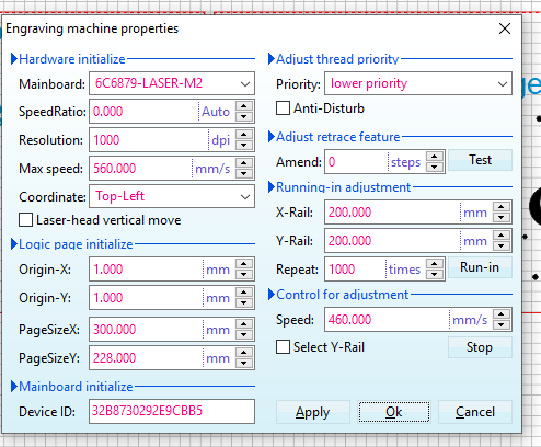

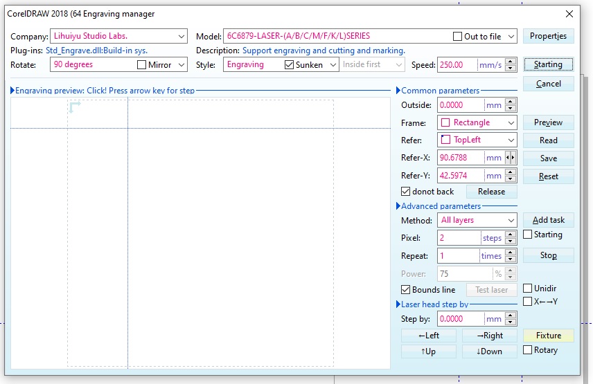

The only scaling issues I’ve really seen are if you change steps / pix anywhere else other than in CorelDraw Settings. Sometime you also get weird things that happen depending on what you have “Cutting Data” set to in the settings menu. You could post a screenshot of your settings and of the cut manager window.

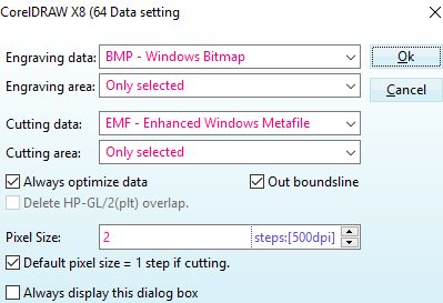

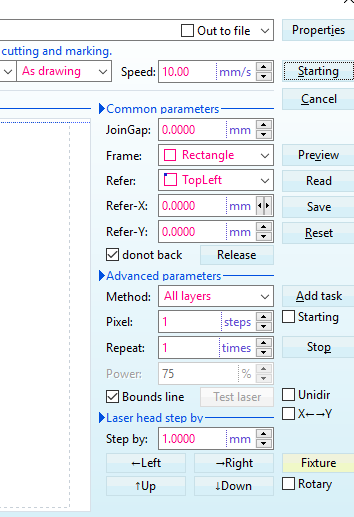

Not sure then. Things may behave differently with a newer version of coreldraw. Here are some settings from corellaser I’ve used in the past in case it helps.

Lots of differences.
At least one seems significant–cutting data file. You have EMF while mine is configured for PLT.
I’d love to see (English) documentation on what all the settings mean.
Thanks!
I’ve found in the past that EMF generally gives the least issues. Sometimes imported svg cut files have been problematic and believe I’ve instead used the PLT instead.
