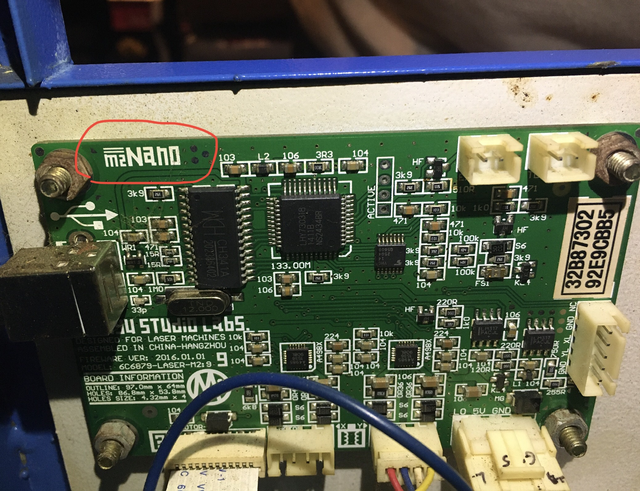

Is there a way to check the main board model? I’ll have to do a little disassembly to see the board–if I do this, will there be identification on the board that could confirm that I have the right model selected?
The board type should be printed right on the board.
How would that name be used to determine if I have the right “model”, eg
6C6879-LASER-(A/B/C/M/F/K/L) SERIES
(That’s what’s in the settings in the laser software)
Actually, I see this in your pic:
6C879-LASER-M2
I’ll open mine up tomorrow and verify the number. If it’s something inconsistent with 6C6879-LASER-(A/B/C/M/F/K/L) SERIES, maybe I can change it to resolve the issue.

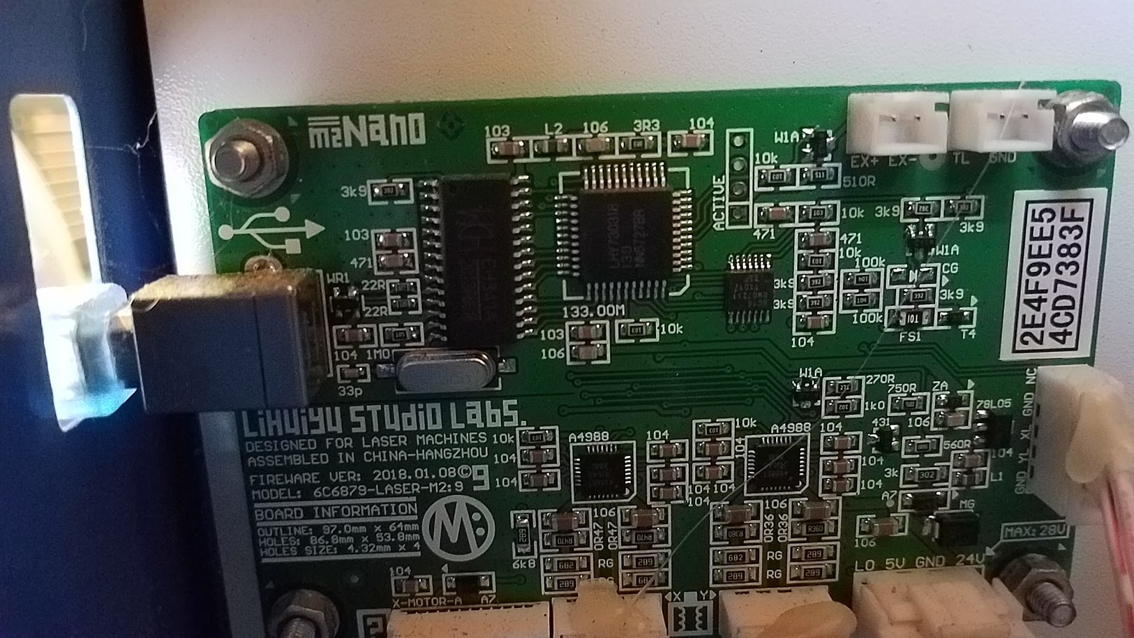

I did check the board version:
So, it seems consistent with the model setting.
