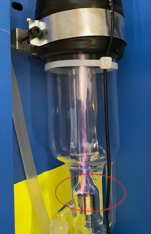

Also when firing the tube, the beam seems to arc towards to anode at the end of tube, I made a video of this, is this normal? Are the 2 problems related at all?

It still leaves me with the question about the arcing inside the tube to the anode, is this normal?
It depends on what you mean by arc. (post picture)
If it looks like an electrical arc then that is not normal and can be the result of a bad tube.
If it is the plasma moving position around the anode that is normal.
In any case seems your tube it bad.
This is what I mean:
For the most part, there is a solid purple beam, but near the end, it get’s bent to the anode, this is what i mean with arc, is this normal? Ordered a new tube, but want to know what is normal/ not normal. Thank you!
I am pretty sure it normal for the plasma to jump around on that ring while fireing.
I had a similar problem after 10 hours of good operation. Turned out there was an air bubble exposing about 30,% of the anode. Replaced the tube and reoriented the water exit as a high point. No more bubbles or problems.
